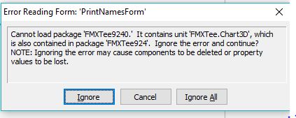

Since installing TeeChart Standard, I've had an issue with a particular error message popping up when I'm trying to load some of my app's units/forms. The strange thing is that the ones that this happens with do not have any TeeChart components on the form, nor are there any TeeChart units defined in the Uses clauses.
Happens using the FMX version of TeeChart and Delphi 10.2 Berlin.
Below is a screen grab of the error message I'm getting.

Thanks, Yeray, that fixed it. I use FastReports, and was able to uncheck their two TeeChart packages, and now the forms load without the error. I don't use charts with FastReports anyway.
Re: Error Message when loading units
I'm glad to hear it works fine now!PastorMic wrote:Thanks, Yeray, that fixed it. I use FastReports, and was able to uncheck their two TeeChart packages, and now the forms load without the error. I don't use charts with FastReports anyway.
