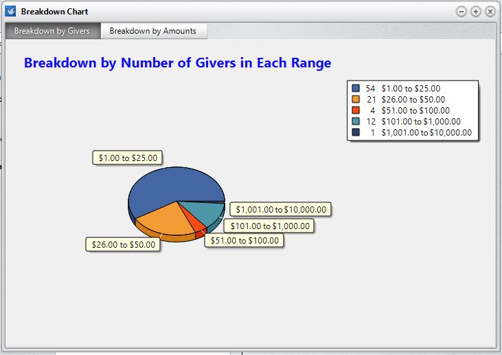

I will upload two screen grabs to illustrate my issue. I have built a dialog in both VCL and FMX versions (Berlin 10.1) using TDBChart. As far as I can tell, I've set the properties the same in the Series 1 Datasource page. The Labels and Pie drop-downs show the same thing in both platforms. But you can see the difference.
The legends are fine in both screen grabs, but in the FMX version, I want to show the number of givers that each slice of the pie represents rather than the giving range that's shown in the legend.
Does anyone know what property to set that will provide this? I can't seem to find a difference in the way I have the VCL and the FMX versions set up, though I'm sure I've missed something. Any help appreciated.
Mic
This is the FMX version. Note the labels on the pie itself. I want them to read the number of people in each range rather than display the range.

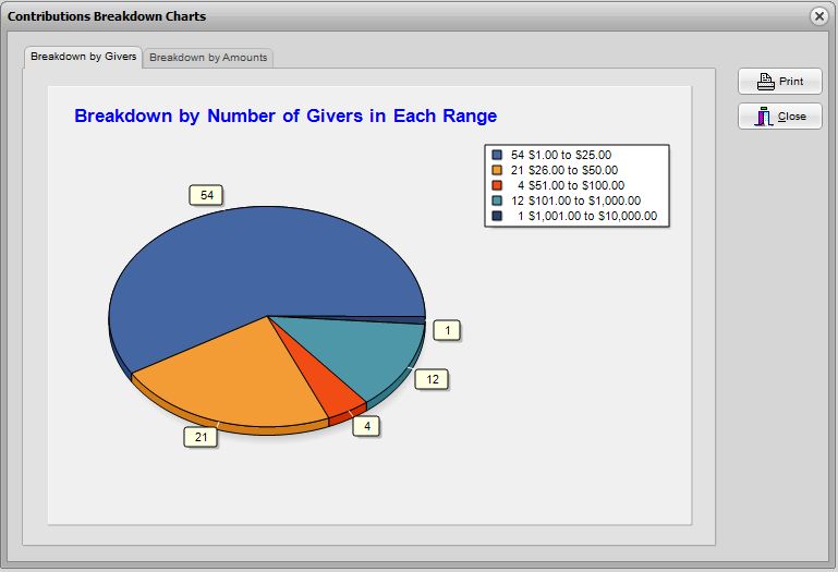

This if from VCL - the way it should look.
