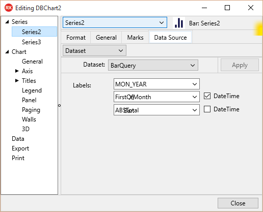

This is what I am doing now and getting ready to add 2 more series for a comparison to last year. So I want to end up with Income/Expenses bars for this year and 2 bars representing last year for comparison.
Here is my code for the 2 chart method:
for i := 1 to 2 do
      Begin

Creating 3 more Queries is no problem, but I want to figure out how I could simplify it. Both Series are the same including database settings (attached.
Re: Creating a 4 Series bar chart
Post by Yeray » Thu May 04, 2017 9:06 am
I believe this is more a SQL doubt than a TChart issue.
The goal would be to create a single SQL query merging those two different queries, generating different columns to link to the series.
