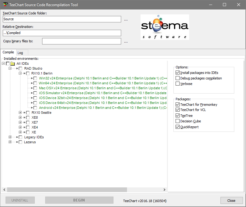

I've just tried to build and deploy a new application with a simple TChart to iOS Simulator and it worked for me without problems with TeeChart Pro v2016.18.
I've tried it both with the binary and the source code versions.
I've also recompiled TeeChart Pro v2016.18 SourceCode version for RAD 10.1 Berlin Update 1 using TeeRecompile tool included and found no errors:

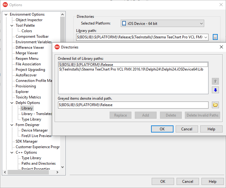

Please check the Library path in your "iOS Device - 64 bit" is correct and has no references to previous installations. By default:
C:\Program Files (x86)\Steema Software\Steema TeeChart Pro VCL FMX 2016.19\Delphi24\Delphi24.iOSDevice64\Lib
Note "TeeInstalls" is an Envioronment Variable defined in my IDE pointing to where I have the TeeChart VCL installations, because I have many.

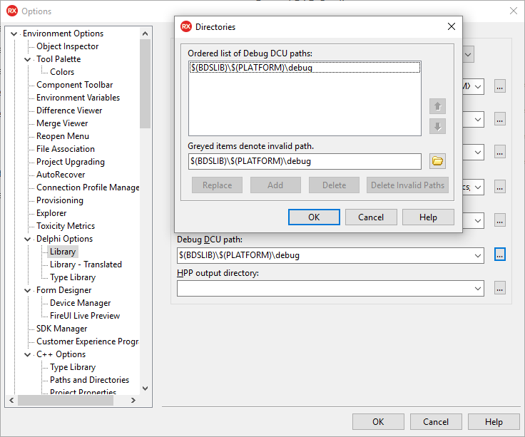

Remove any "tee" entry in "Browsing path" and "Debug DCU path":
