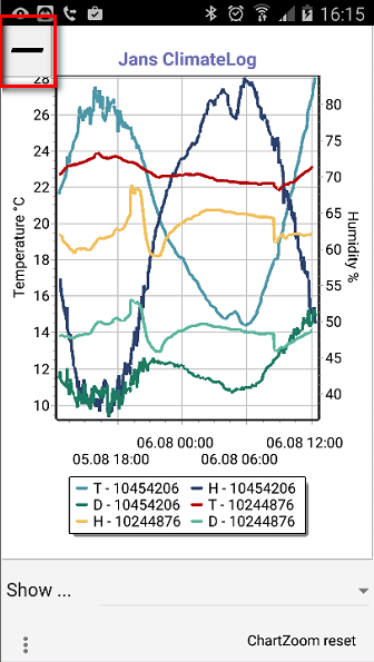

I use LoadChartFromFile on Android with the .tee - format.
The resulting chart contains an element which is not there/visible in the saved chart (see attachment).
Loaded chart with strange element...
strange steema chart artefact -2015-08-11_161530.png (69.76 KiB) Viewed 29658 times
Has anybody an idea what element that might be, so I can set its visibility to false after using LoadChartFromFile?
Best regards
Roland

Post by Narcís » Tue Aug 11, 2015 2:42 pm
Hi Roland,
You could save the chart in text format using TeeStore.SaveChartToFile and setting the last parameter to true. That should give you the .dfm code for the .tee file and you can see which objects are in the chart. Also, does this occur with all .tee file or some specific files only? We would be interested in a test case we can run "as-is" to reproduce the problem here.

I checked the DFM text and cannot see anything what would explain it (see below) ...
My guess is that something in the LoadCharFromFile procedure and the TMultiView component is interfering.
I would be happy to send the Android project to you - but it will also contain TMS components ...

Re: Problem with LoadChartFromFile on Android
Post by Narcís » Wed Aug 12, 2015 7:43 am
Hi Roland,

Roland wrote:I checked the DFM text and cannot see anything what would explain it (see below) ...
Yes, nothing evident here without being able to reproduce the problem.
Roland wrote: I would be happy to send the Android project to you - but it will also contain TMS components ...
Can't you reproduce this without TMS components? Otherwise we may not be able to reproduce the problem here.

I created a testproject with only Delphi XE8 standard components and TChart which I do not mind to attach here ...
The following steps are needed to reproduce the problem:
1. Run the app ...
2. Click on the button at the bottom "btShowMultiView"
3. click on the button btSaveChart
4. Close the app
5. Reopen the app
6. See the strange artefact ...
Best regards and thanks for your support
Roland
Post by Narcís » Wed Aug 12, 2015 11:44 am
Hi Roland,
Thanks for the project. I couldn't run it because of this error though:
[MSBuild Error] The "CreateAndroidManifestFile" task failed unexpectedly.
System.UnauthorizedAccessException: Access to the path '\..\..\AndroidManifest.template.xml' is denied.
at System.IO.__Error.WinIOError(Int32 errorCode, String maybeFullPath)
at System.IO.File.InternalCopy(String sourceFileName, String destFileName, Boolean overwrite)
at Borland.Build.Tasks.Shared.CreateAndroidManifestFile.genManifestFile()
at Borland.Build.Tasks.Shared.CreateAndroidManifestFile.Execute()
at Microsoft.Build.BuildEngine.TaskEngine.ExecuteInstantiatedTask(EngineProxy engineProxy, ItemBucket bucket, TaskExecutionMode howToExecuteTask, ITask task, Boolean& taskResult)
Anyway, it served me as the basis for a similar project which reproduced the problem and added it to bugzilla (bug #1271). Also found a workaround to it, which consists on loading the chart as shown in the code snippet below. My project already demonstrates the bug and the workaround.
var tmpChart : TCustomChart;
  if FileExists(TPath.GetHomePath + 'test.tee') then
    tmpChart:=TChart.Create(Self);
    LoadChartFromFile(tmpChart, TPath.GetHomePath + 'test.tee');
    Chart1 := tmpChart as TChart;
    Chart1.Parent:=Self;
AndroidImportArtifact.zip
(59.29 KiB) Downloaded 1647 times
