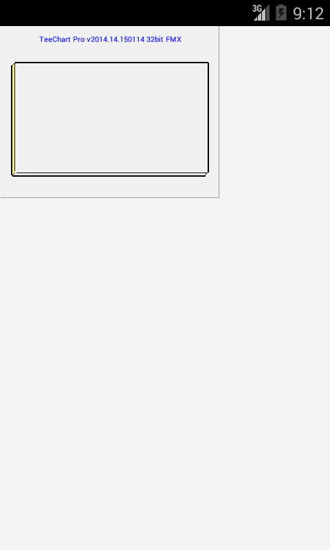

Some more info about the test we are doing here.
There seems to be some difference between XE5 and XE7 because the same code below gives a correctly aligned chart in XE7 but not in XE5, both using the latest TeeChart version v2014.12 (images generated using the internal sources):
uses FMXTee.Chart, FMXTee.Constants;
var Chart1: TChart;
  Chart1:=TChart.Create(Self);
  Chart1.Parent:=Self;
  Chart1.Align:=TAlignLayout.alTop;
  Chart1.Title.Text.Text:=TeeMsg_Version;

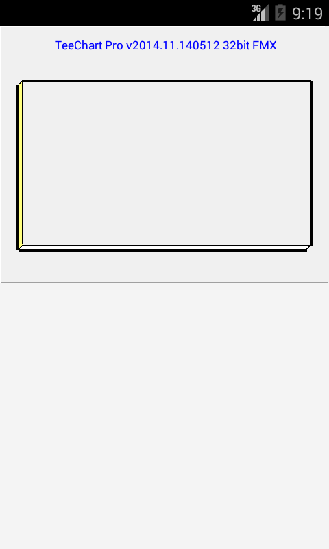

On the other hand, using the previous TeeChart v2014.11 in XE5, the chart seems to respect the alignment:
I see you added this to the public tracker (ID 1071). I've just confirmed it and linked to this thread.
In the meanwhile, could you please check if TeeChart v2014.11 fits your requirements?
