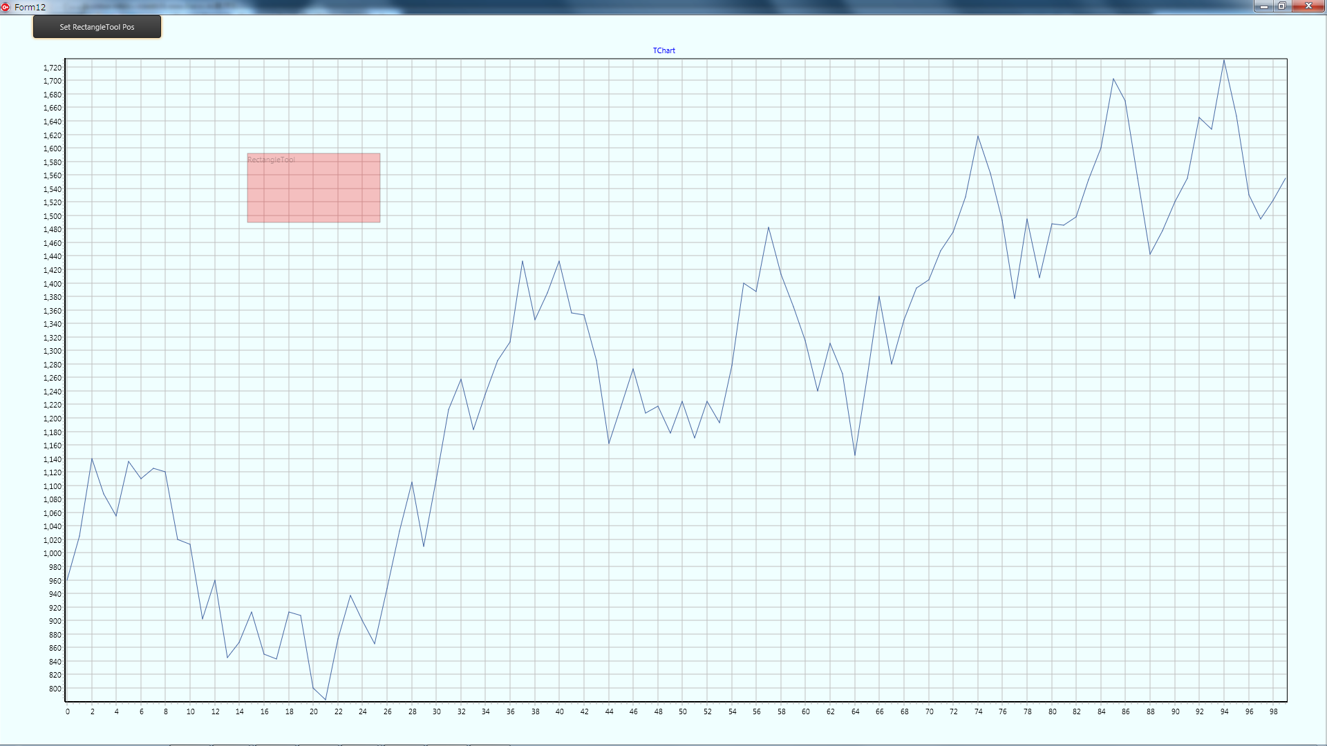

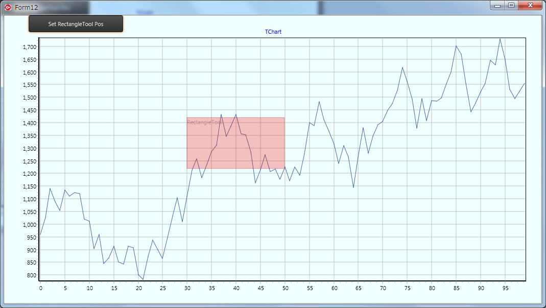

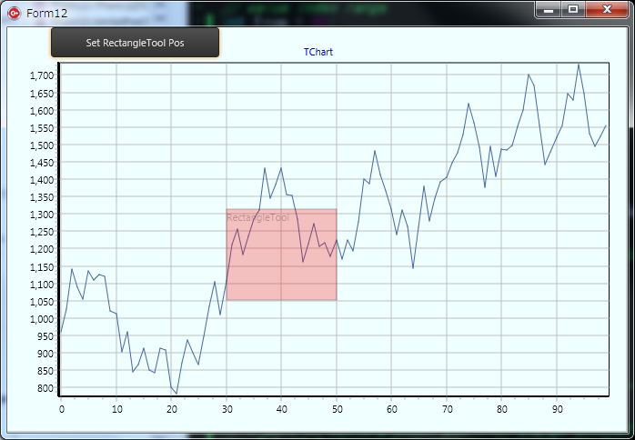

I want the RectangleTool position change automatically when form size changed.
But if I change form size by dragging the from border, it seems OK,
while nothing changed when maximize the form.
Resize Form by Maximizing Form.png (192.17 KiB) Viewed 17332 times
Resize Form by Dragging Form Border.png (84.84 KiB) Viewed 17334 times
Before Resize Form.png (75.94 KiB) Viewed 17332 times
