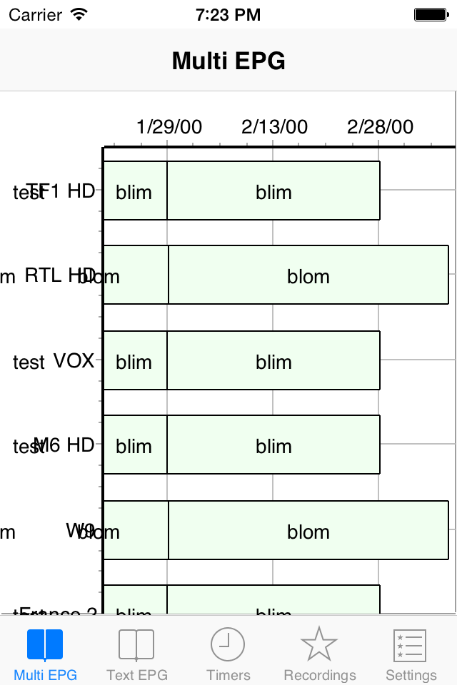

Hi all,
I just noticed that in the latest TeeCharts, the TGanttSeries marks remain visible beyond an axis - can this be changed somehow?
(see attachment).
Cheers

Post by Yeray » Mon Jun 30, 2014 1:54 pm
Try with:
Series1.Marks.Clip:=true;

Post by cjacoby78 » Mon Jun 30, 2014 3:33 pm
Yes!
This did the trick!
Thanks a lot!
