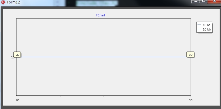

cannt change the color of marks
Post by elmec » Thu May 22, 2014 4:34 am
The color cannt be changed by the following code.
BTW, I am using the newest Teechart(2014) for C++Builder XE4 Firemonkey HD APP.
#include <fmx.h>
#pragma hdrstop
#include <iostream>
#include <string>
#include "Unit12.h"
#pragma package(smart_init)
#pragma resource "*.fmx"
TForm12 *Form12;
__fastcall TForm12::TForm12(TComponent* Owner)
	: TForm(Owner)
	seriesSeries1->Marks->Visible = true;
	seriesSeries1->AddXY(10,10, "aa", claRed);
	seriesSeries1->AddXY(20,10, "bb", claBlue);

Is this a TLineSeries? I can't reproduce this with a TLineSeries.
If it's a TFastLineSeries, note this.
Reading the thread title again it mentions the marks. So I'm not sure if the intention of the code you posted was to set red and blue colors to the marks or to the line pen. If you want to change the marks colors, you have to use the corresponding Marks Items array after populating the series:
   Chart1->View3D = false;
   TFastLineSeries *seriesSeries1 = new TFastLineSeries(this);
   Chart1->AddSeries(seriesSeries1);
   seriesSeries1->Marks->Item[0]->Color = claRed;
   seriesSeries1->Marks->Item[1]->Color = claBlue;

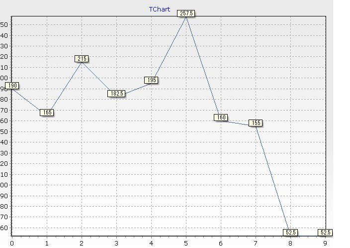

But I am confused about the result of the following code.
    TFastLineSeries* line = new TFastLineSeries(Chart1);
    line->ParentChart = Chart1;
    line->Marks->Visible = true;
    line->FillSampleValues(10);
    // the count fo marks is  ZERO!!!   Even all the marks are showed just like in the attachment.
    ShowMessage(line->Marks->Items->Count);
marks count.png (15.54 KiB) Viewed 18509 times
Re: cannt change the color of marks
Post by Yeray » Fri May 23, 2014 10:03 am
The problem here is that the Marks->Items array is being populated as you access it; if you access the Marks->Item[index], the array is populated from the item 0 to the item being accessed, and Marks->Items->Count always indicates how many items are populated in the array.
Ie, if you access to the Item[0], then the Count will give you 1:
	line->Marks->Item[0];
Or, if you access the item[3], then the Count will give you 4:
	line->Marks->Item[3];
Then, if you want to get the complete Count, you have to access the last item. Ie:
	line->Marks->Item[line->Count()-1];
