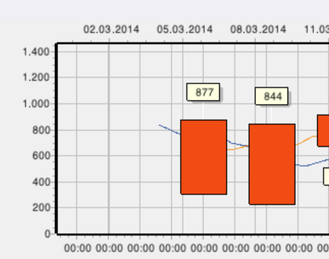

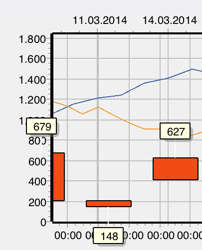

If use BufferedDisplay = true, characters look like this (smeared)
If I use BufferedDisplay = false characters look OK - like this: (clear)
Re: Mobile Performance
Post by Yeray » Thu Mar 06, 2014 11:10 am
This is a known effect. Maybe you can vote for this report at Embarcadero's QC:
http://qc.embarcadero.com/wc/qcmain.aspx?d=122373
We also suspect FMX may be doing something wrong when the destiny canvas is a TBitmap (BufferedDisplay=True) giving blurred texts. We're investigating this.

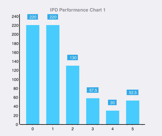

I hadn't thought of the Simulator, but actually I can reproduce a bit of the problem there - it is actually worse on the device, but can you see the difference quite clearly in quality.
Non Retina
Retina
Post by Yeray » Mon May 12, 2014 10:49 am
Right, switching to iPad Retina simulator I could also reproduce the problem.
We're investigating this further.
