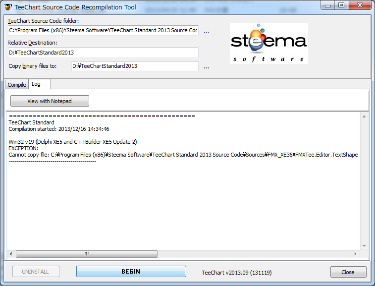

couldn't recompile by TeeRecompile.exe.
file not exist FMXTee.Editor.TextShape.pas.
before
after
Re: XE5 TeeRecompile.exe problem
Post by Yeray » Tue Dec 17, 2013 1:03 pm
I could reproduce the problem and we are working on a solution. We'll be back to you here asap.

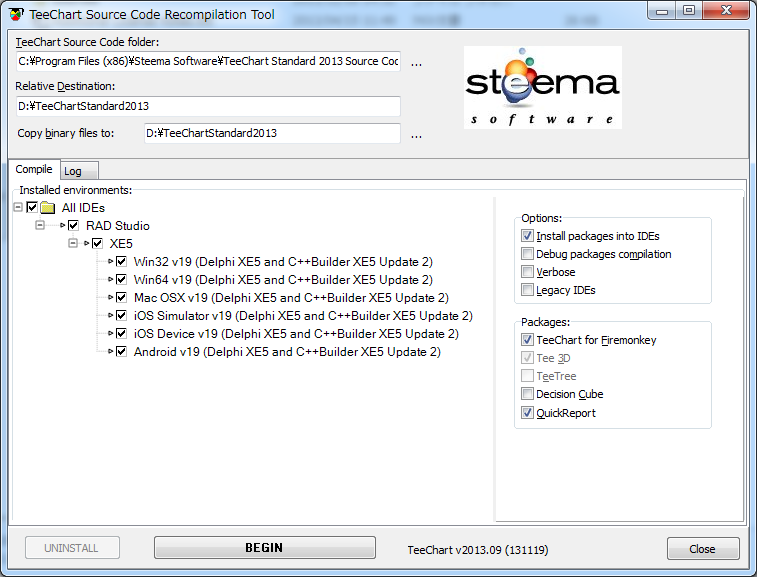

Please tell me the recommended setting of Recompile.
TeeChart Source Code folder:
C:\Program Files (x86)\Steema Software\TeeChart Standard 2013 Source Code\Sources
Relative destination:
Compiled ??
Copy binary files to:
And Please tell me delphi settings to run in iOS Device.
my environment is
windows7 enterprise 64bit.
Delphi XE5 Update2

EXCEPTION:
Cannot copy file: D:\TeeChartStandard2013Standard\Delphi19.win32\System\Tee919.bpl to D:\TeeChartStandard2013\Tee919.bpl
Error Code: 3 Description: 指定されたパスが見つかりません。
D:\TeeChartStandard2013Standard\Delphi19.win32\System\Tee919.bpl is Exists.

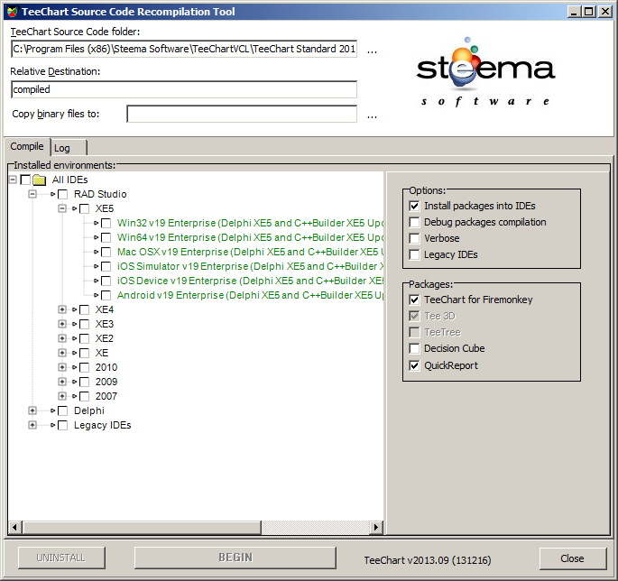

Post by Yeray » Fri Dec 20, 2013 9:52 am
Here it is a snapshot:
makoto wrote:Please tell me the recommended setting of Recompile.
I installed the sources to a slightly modified path because I have many TeeChart installations I want to keep:
C:\Program Files (x86)\Steema Software\TeeChartVCL\TeeChart Standard 2013.09.131217 Source Code (Beta)
You can see the rest of the settings in the snapshot, I just use the default settings TeeRecompile suggests.
makoto wrote:And Please tell me delphi settings to run in iOS Device.
Nothing special for TeeChart. Just the same requirements and procedure than with any other iOS application in XE5.
http://docwiki.embarcadero.com/RADStudi ... evelopment
http://docwiki.embarcadero.com/RADStudi ... iOS_Device
makoto wrote:EXCEPTION:
Maybe it's the D:\TeeChartStandard2013 path, the destination path, the one that doesn't exist.
If you still find any problem with it, please don't hesitate to let us know.
