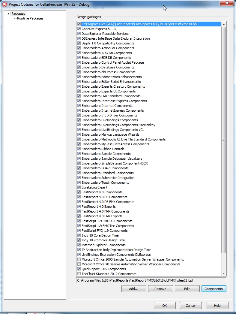

Re: XE4 Fmx Teechart Standard installion problems
None of the files you named are in the packages list
The only possible candidates I can see (both from FastReports) are shown highlit in the two screendumps attached (combined these screendumps show the full list of installed packages I have)
Hi Uncork,
Yes, that must be the problem then, FastReports packages that are still using the old TeeChart versions. You could try disabling them and enabling new TeeChart packages. If that works then you should consider updating your FastReports for TeeChart components to your current TeeChart version. You could ask FastReports for packages compatible with your TeeChart version or, if you have FastReports sources, do something similar to what's explained in the QuickReport article.
