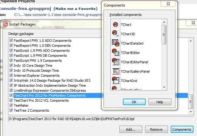

I'm running C++ Builder Architect XE4 IDE, version 18.0.4854.59655.
When instaling full source TeeChart Pro package released on May 21, 2013, Build 2013.08.130521, TChart component is missing from design palette for FMX application. TChart3D is there, though.
Strangely enough, TChart icon is visible, when I browse IDE menu Component->Install packages...->Design packages->Components for TeeChart.
I see, that proper 2013 Pro DclFMX is loaded, though it's still named TeeChart Pro 2012 there.
Proper Dcl FMX TeeChart package is loaded, TChart icon is shown there.
But, upon creation of new FM3 application, the TChart component is missing from design palette.

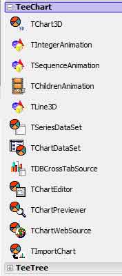

At this moment I'm not sure if the TChart Lite component was in the "TeeChart" tab where the Pro is, or if it was in another tab like "Additional". Maybe it's still where it was the Lite component. Have you tried writting "tchart" in the Tool Palette search?

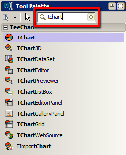

Yep, I thoroughly tried to find where TChart design time has gone, or at least, tried to understand what is going on, but no luck, alas.
Here is what is filtered in IDE ToolPalette for FMX, when typing "tchart":
"tchart" filtered in ToolPalette
Another obvious sign that design time component is missing - existing projects, which contained forms with TChart will not load form designer with error, like: "TChart component is unknown, Ignore - delete component, Cancel - abort form designer loading".
What is more, comparing your screenshot with mine, it occurred, that in my case there are no ListBox, EditorPanel, GalleryPanel, Grid components (assuming your example is taken in FMX environment as well).
