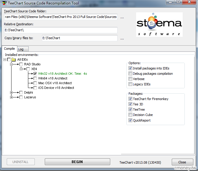

XE4 win32 v18 Architect ERROR, Options: Install packages into IDEs
EXCEPTION:
Can't load package C:\Program Files (x86)\Steema Software\TeeChart Pro 2013 Full Source Code\Sources\..\TeeTree\Compiled\Delphi18.win32\Bin\DclTree2D18Tee9.bpl.
XE4 win32 v18 Architect ERROR, Options: DebugPackages compilation
Has been successfully,

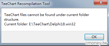

but, when I installed, an message :
"TeeChart files cannot be found under current folder structure."
thanks for your help.

Re: TeeChart VCL/FMX for XE4 BETA installers published
Hi Brian,
Since you changed the "copy binary files to" folder, you will have to copy/move them manually to the Windows/System32 folder (SysWOW64 if you are in a 64bit OS). Don't hesitate to let us know if this solves the issue for you.
Move/copy all the files in your "E:\TeeChart" folder, not the folders or their content.
If you still find problems with TeeTree, unselect it if you don't need it.
