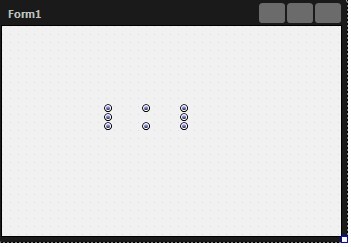

after installed TeeChart 2011.04.41118, and I new a firemonkey HD application.
put a button in from, but can't show button.
- aa.jpg (15.92 KiB) Viewed 45946 times

Hi xalion,
I could reproduce the issue here but I'm not sure if this is related to TeeChart or not as after completely removing all TeeChart traces from the IDE the problem still occurs, we will investigate the issue here and get back to you when we have further news.
BTW: Do you have any XE2 without TeeChart installed on it? Could you reproduce the issue there?

After some testing here we found it may be related to another random issue we found with TeeChart. If you double-click a TChart component at design-time can you see the chart editor or just an "empty" dialog? None of those work fine for me while it does in other machines.
