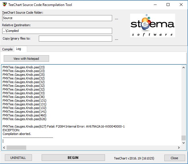

Hi again!
This time I tried to run as administrator the TeeChart Recompilation tool as you proposed.
The error is still visible.
Check the image below.
error
Regarding the source files , we have not modified anyone ad to be sure we run the process in another laptop (second license) and still the same.

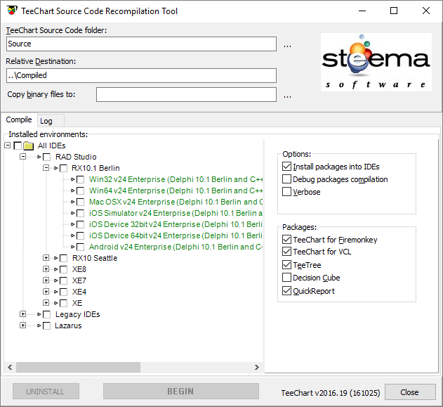

Is there any case, any of the options & packages for compilation (in our case I have checked all of them) could create any conflict?
Also, I observed that when tool starts to compile each one of ios/android devices, gui often stucks and window appears like "not responding).
Lets say that for now we can do our job with compilation files for win32/64 , macos and ios simulator: Is there any possibility that this failed compilation has left any unwanted staff ?
BR
Re: error installation Pro VCL FMX
Post by Yeray » Wed Feb 15, 2017 11:54 am
radberlin wrote:Is there any case, any of the options & packages for compilation (in our case I have checked all of them) could create any conflict?
I could reproduce the fatal error you are reporting selecting "Debug packages compilation".
I found another error arises if you select "Decision Cube".
We'll investigate these problems.

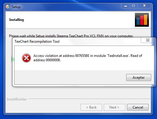

Hi My name is José luis. I am to installing the software teecchart Pro VCL/ FMX but that the end of instalation show me the next window. I would like to use this tool for complet to visual studio 2017 some one tell me what is the reason?. Thanks
error window
Captura error teechart.JPG (40.45 KiB) Viewed 23613 times
Post by Yeray » Wed Jul 26, 2017 6:12 am
Hello José Luis,
SoftCho2017 wrote:I would like to use this tool for complet to visual studio 2017
I guess you are interested in TeeChart .NET, not TeeChart VCL/FMX.
