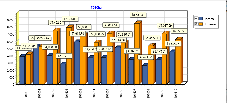

Post by realsol » Wed Mar 15, 2017 7:21 pm
I have attached my chart. How can I change the legend to show the Series Name along with the Total value of the Series?
Re: Legend, show Series Name and Series Total Value
Post by Yeray » Thu Mar 16, 2017 1:17 pm
You could use OnGetLegendText event. Ie:
procedure TForm1.Chart1GetLegendText(Sender: TCustomAxisPanel;
  LegendStyle: TLegendStyle; Index: Integer; var LegendText: string);
var i: Integer;
  if Index<Chart1.SeriesCount then
    LegendText:=LegendText + ' $' + FormatFloat('#,##0.##', Chart1[Index].YValues.Total);

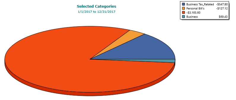

I have another question along this same lines. I have a pie chart of categories (Attached). If transactions don't have any assigned category, the legend just displays the amount. I would like to add the text 'No Categories' in front of the amount but I can't seem to format it the way it is in the legend (Text left justified and amount right justified).
Post by Yeray » Fri Jul 14, 2017 7:18 am
realsol wrote:I have another question along this same lines. I have a pie chart of categories (Attached). If transactions don't have any assigned category, the legend just displays the amount. I would like to add the text 'No Categories' in front of the amount but I can't seem to format it the way it is in the legend (Text left justified and amount right justified).
I'm not sure to understand why don't you add the uncategorized value as you do with the others, with the "No Categories" label. Ie:
  Series1.Add(316560, 'No Categories');
In case you are adding the values connecting the series to a dataset, you can loop your values and set the label at those points with empty labels. Ie:
  for i:=0 to Series1.Count-1 do
    if Series1.Labels[i] = '' then
      Series1.Labels[i]:='No Categories';

Thanks. I ended up using the OnGetLegendText for the Chart and added
if Series1.Labels[Index] = '' then
      Series1.Labels[index]:='No Categories';
Worked perfectly. Thanks.
