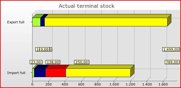

Re: Center mark in Bar and HorizBar
They have indeed a custom position.
But not the position I want.
I have the bars 'stacked'.
Does that influence the behavior of the marks?
- custom_mark_pos.JPG (35.64 KiB) Viewed 74978 times
Hi Martin,
The different possibilities like Bar/HorizBar series, or the MultiBar style (Stacked,...) should be handled manually while the MarksOnBar feature isn't implemented.
Here you can find an example in VCL where the same was discussed.
http://www.teechart.net/support/viewtop ... bar#p59305
