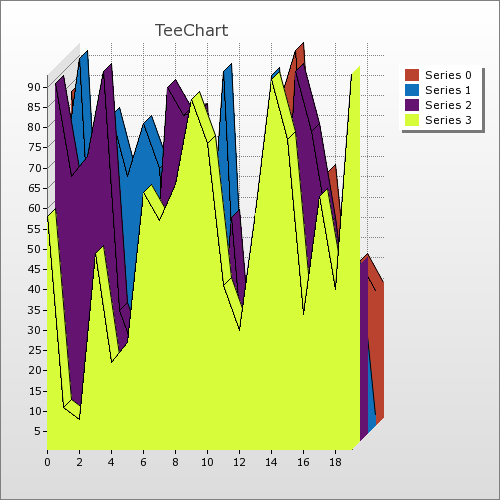

I am attempting to add 2+ area series to a chart. It works, but unfortunately, there is a visual bug. First, the chart is displaying in 3D. The series that is in the back has its front face drawn at the same depth as the series in the front (like someone has separated the front from rest of the area chart). (Unfortunately, my web site is still on the internal network so I cannot show you the visual bug). Has this bug been reported? Is there a work-around? I have the source if that helps.

I've tried with the following simple code and I can't see the visual problem you mention.

Here is what I'm getting. Isn't it the same result for you?

I think I found the problem. It looks like the error may only occur with Stairs = true. If setStairs is false, I see no problem. Could you try your code with
$area_chart->setStairs(true);
Tom

Yes, you are right. I could reproduce it so I've added it to the defect list to be fixed in future releases (TF90014953).
