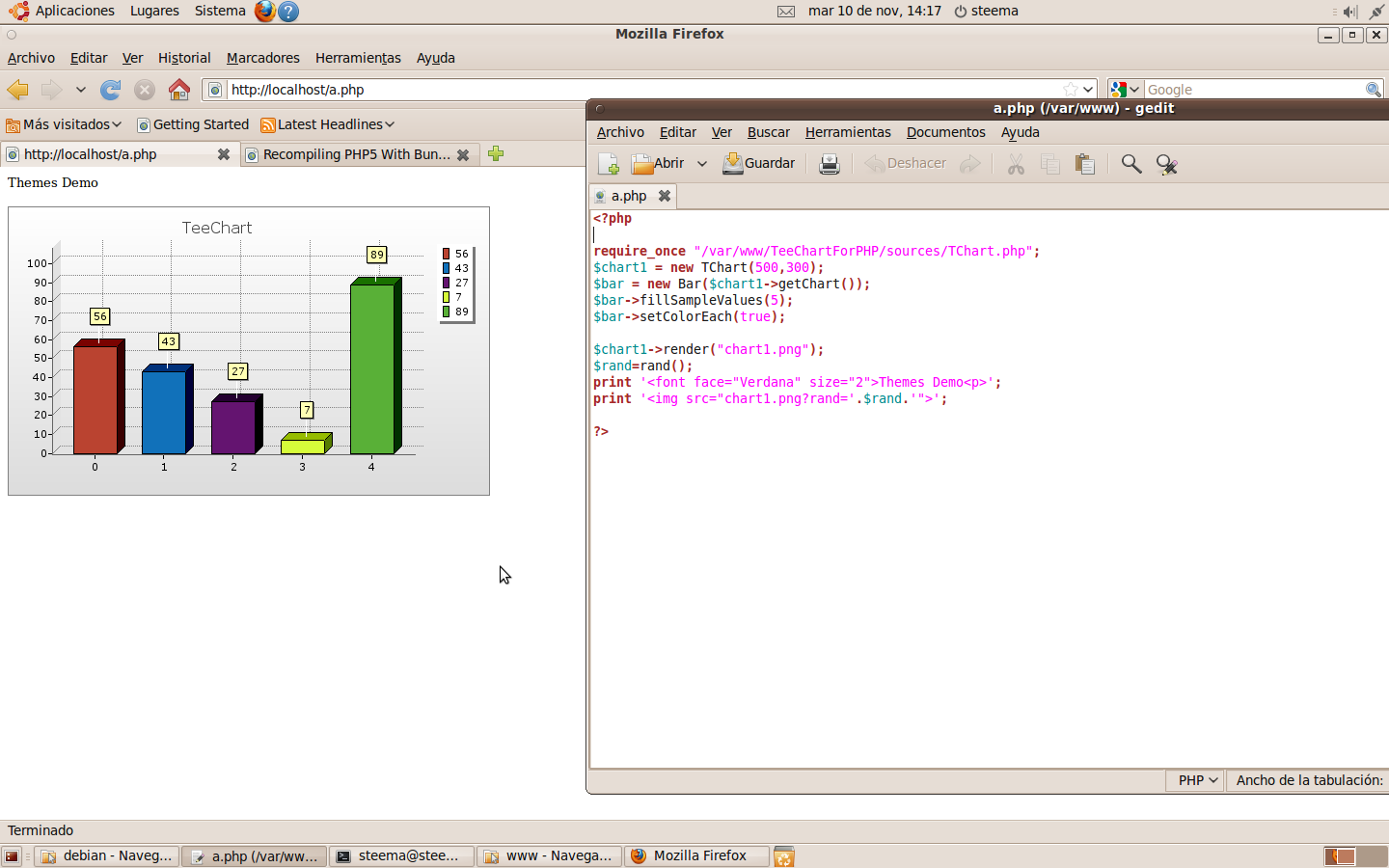

Yes, I've made a test in a fresh install of Ubuntu 9.10 the last week and I've found some problems with GD library but I managed to run it by recompiling the PHP following this instructions.
See the attached example that worked for me here:
a.zip
(342 Bytes) Downloaded 5743 times
And the result:

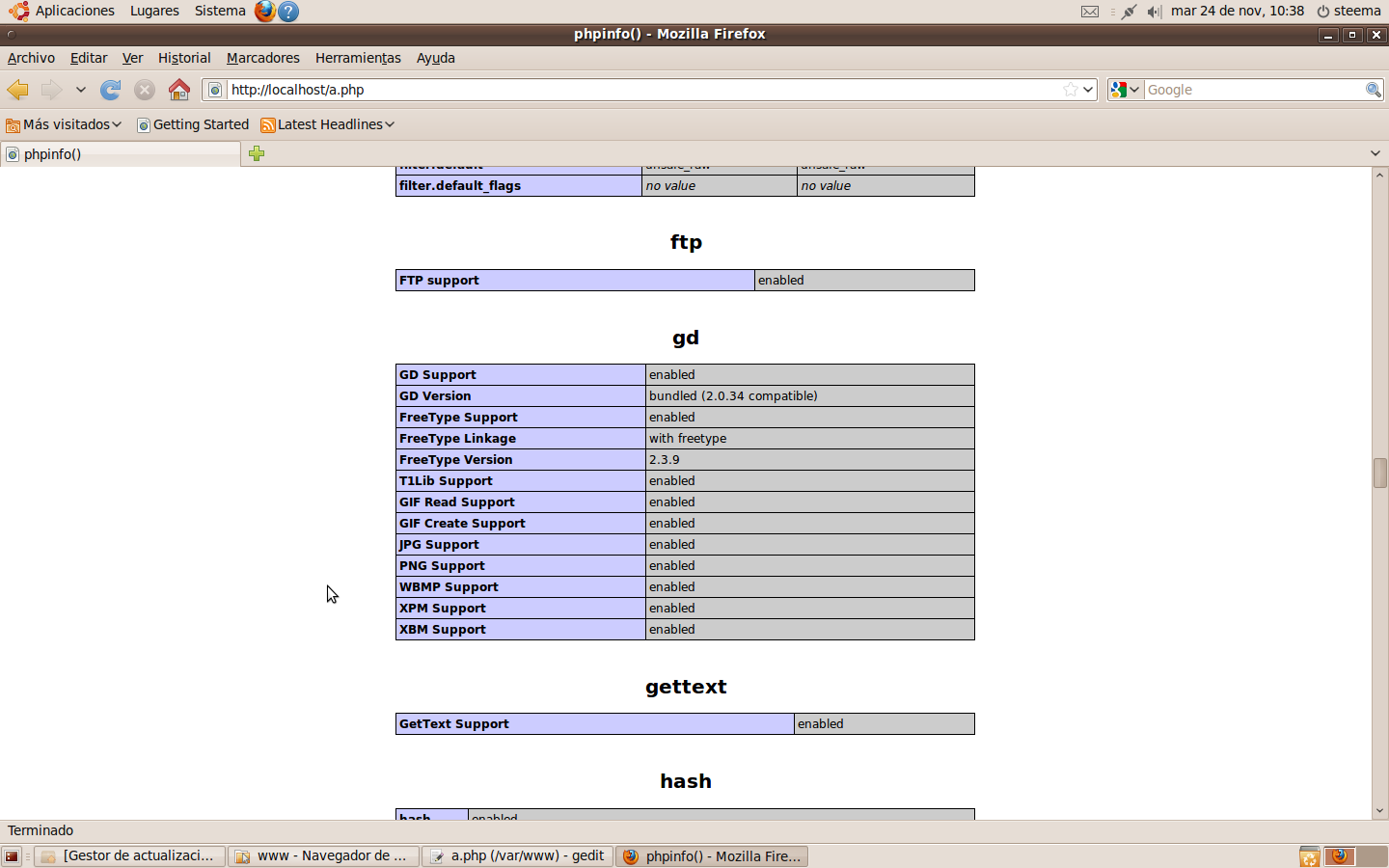

Another test you could do would be adding the phpinfo(); call in your a.php file and see if the GD library is correctly loaded:

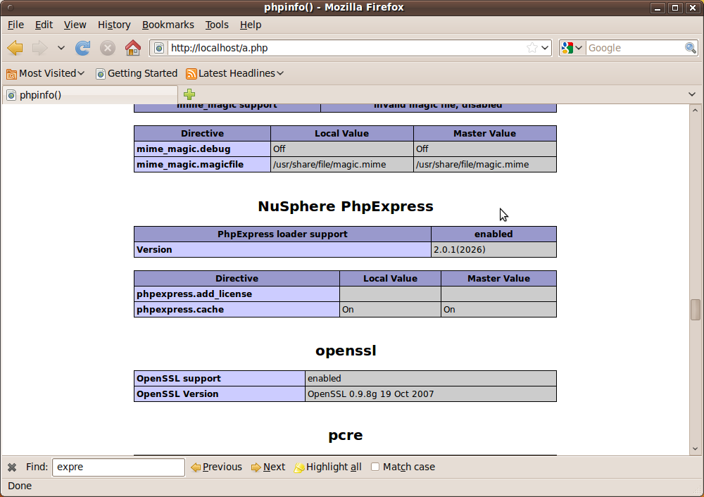

streamfoundry wrote:You sure the extension=phpexpress-php-5.2.so statement isn't still in there?
After loading them in the beginning of the process, I could see them enabled running the phpinfo function.
And at the end of the process, after removing them from the php.ini, I can't find them in the phpinfo function result, but the chart seems to work without problems. :shock: + :? = 8)
