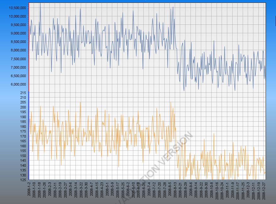

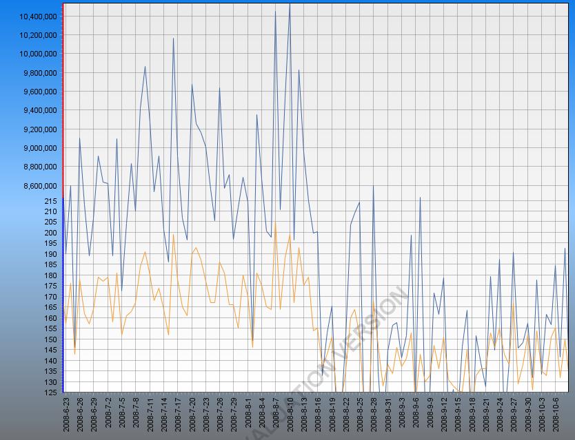

I have custom vertical axis, below this left (Y) axis. When I zoom series on left (Y, default) axis, it is zoomed within the left area. Where as If zoom the series on custom axis, the series is zoomed and drawn on left (Y) axis' area also. Please look into attachment.
Thanks and Best,
Veeranna Ronad.
after zoom
before zoom

Hi Veeranna,
Custom axes don’t support zooming. You can find how to implement zoom for custom axis at the URL below. It’s Delphi/C++ Builder code but same can be applied to TeeChart for Java version.
http://www.steema.com/support/faq/NewVC ... ES.htm#Q15
Hope this helps!
