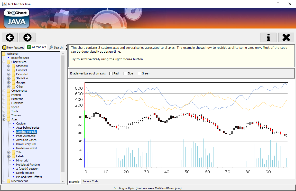

An alternative would be to add a custom axis at the left side and assign a zone to each axis, like in the MultiScrollDemo:

Here another example about using custom axes:
