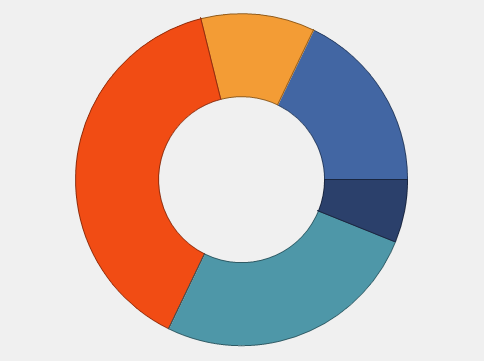

Thanks for the update. Here a sceenshot of a donut chart and the configuration:
 chart.getAspect().setSmoothingMode(true);
    chart.getAspect().setTextSmooth(true);
    chart.getAspect().setView3D(false);
    chart.getAspect().setOrthogonal(true);
    chart.getLegend().setVisible(false);
    chart.getHeader().setText("");
    chart.getPanel().getBevel().setOuter(BevelStyle.NONE);
    chart.getPanel().setMarginTop(0);

We are investigating. The TeeChart smoothing method appears to be calling correctly the underlying graphics class, we can note a barely discernible difference (before/after) so something is processing; but it is not the response we would expect.

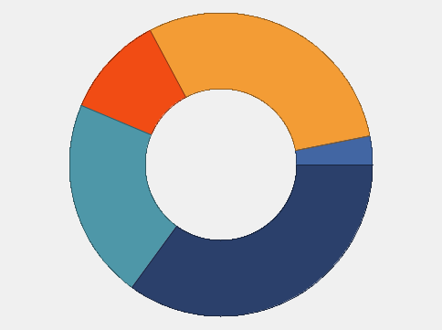

We haven't finished it, but I can show you how the tests currently are:
The same chart without the modifications:

Ohh great. that looks much better. looking forward to the next release :-)
