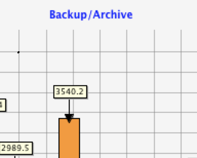

Hello.
In Mac OS font inside charts have blur fonts.
How does it fixed?
p.s.
In windows is all ok
Dmitry
How does it fixed?
p.s.
Dmitry
- Screen Shot 2014-08-05 at 12.52.44.png (17.83 KiB) Viewed 97669 times

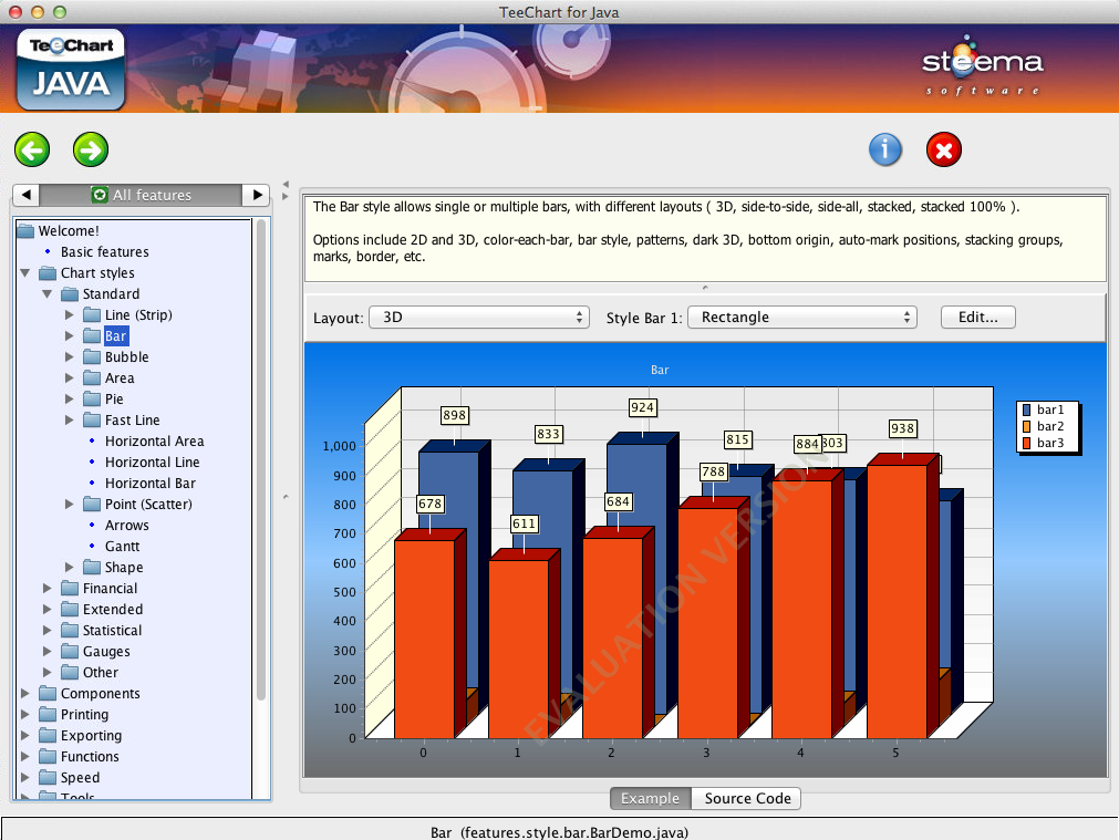

builded swt examples
too same
bluuuur
too same
bluuuur
- Screen Shot 2014-08-06 at 23.50.50.png (21.01 KiB) Viewed 97606 times

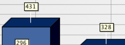

Re: Blur fonts
one more screenshot
- Screen Shot 2014-08-06 at 23.54.45.png (182.58 KiB) Viewed 97607 times

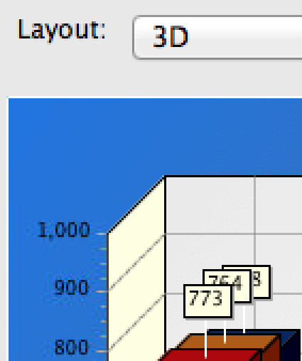

Re: Blur fonts
I assume you are zooming the image. Here it is what I get without zooming it: Now, if I zoom this image a 300% I get this: Note TeeChart texts look as blurred as the labels and other texts in the application, isn't it?
