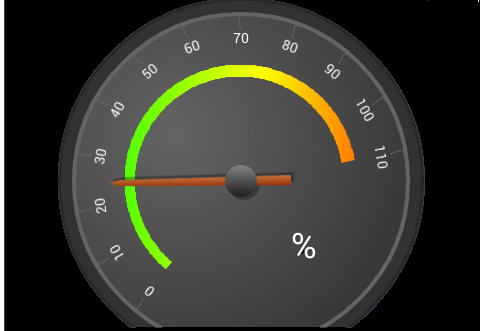

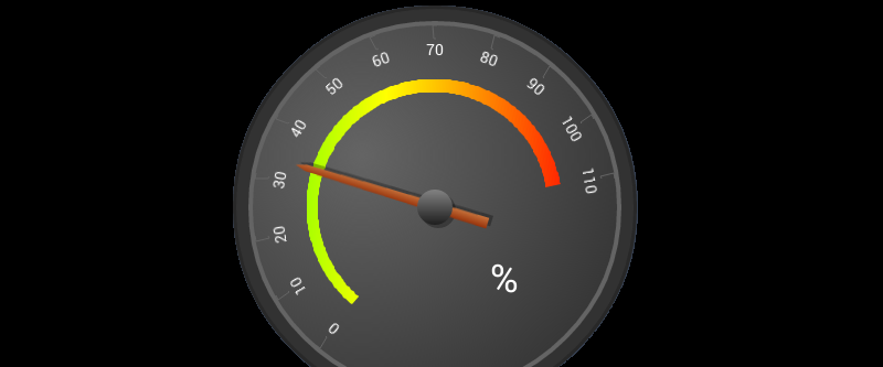

Here is an example of what I said about the differences at the gradient color.
The images show how the gradient looks at the landscape and portrait view.
Following is the main code I have used to setup the gradient.

Re: Android CircularGauge green line color affects ticks color
Post by Yeray » Thu May 29, 2014 12:00 pm
You may be interested on reading the discussion here, where the limitations on the gradients in CircularGauges are exposed.
