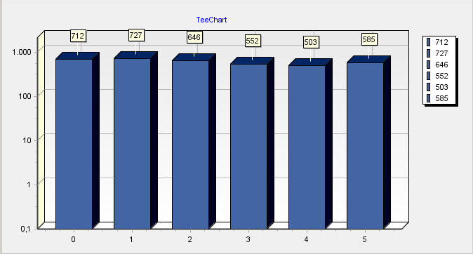

Btw, do bars and line charts support logarithmic axis?
Re: Android CircularGauge Logarithmic axis
Post by Yeray » Fri May 16, 2014 7:30 am
Yes, take a look at the following code:
        Bar bar1 = new Bar(tChart1.getChart());
        bar1.fillSampleValues();
        try {
            tChart1.getAxes().getLeft().setLogarithmic(true);
        } catch (ChartException ex) {
            Logger.getLogger(ChartJFrame.class.getName()).log(Level.SEVERE, null, ex);
This is how it looks the chart after running the above:
