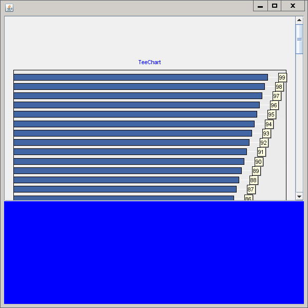

I am working on teechart using horizontal bar series and I would like to know, how can i use a TeeChart with JScrollViewer?
I realized an implementation, but when I scrolling, the component (TeeChart) paint wrong (out of limits).
Please help me to solve the problem.
Implementation:

Re: TeeChart with JScrollViewer
Post by Yeray » Fri May 09, 2014 2:00 pm
Hi Gustavo,
Are you using TeeChart Java v3.2013.1219?
I've pasted your exact code in a NetBeans project and this how it looks for me here:
Post by Yeray » Mon May 12, 2014 8:26 am
Hi Gustavo,
First of all I'd suggest you to download the latest evaluation version available and try to confirm this is fixed with it.
If you confirm it, then you can update your registered version, or, if you own the sources, try to apply the change that fixes the issue yourself.
