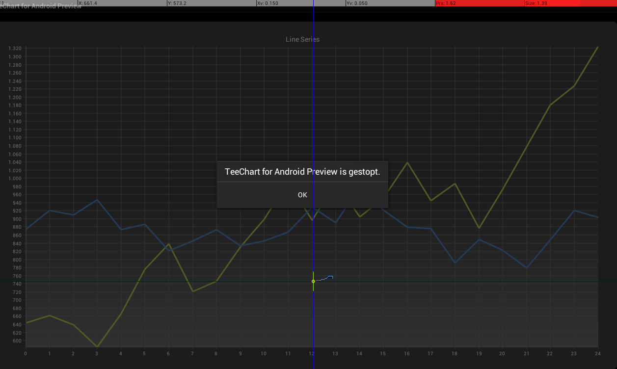

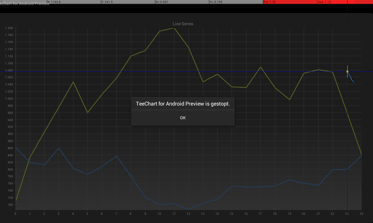

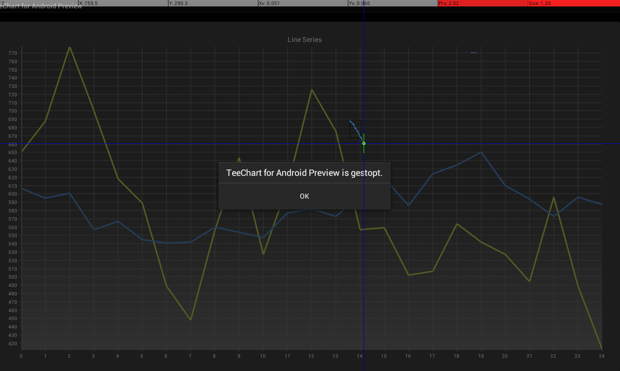

Hello
I have reproduced the problem and i used a tool to see what kind of motion was made before it crashed.
Reproduced on : Motorola Xoom 2
- HistoryPosOutOfRange3.png (83.07 KiB) Viewed 41220 times
- HistoryPosOutOfRange2.png (85.56 KiB) Viewed 41215 times
- HistoryPosOutOfRange.png (84.44 KiB) Viewed 41232 times

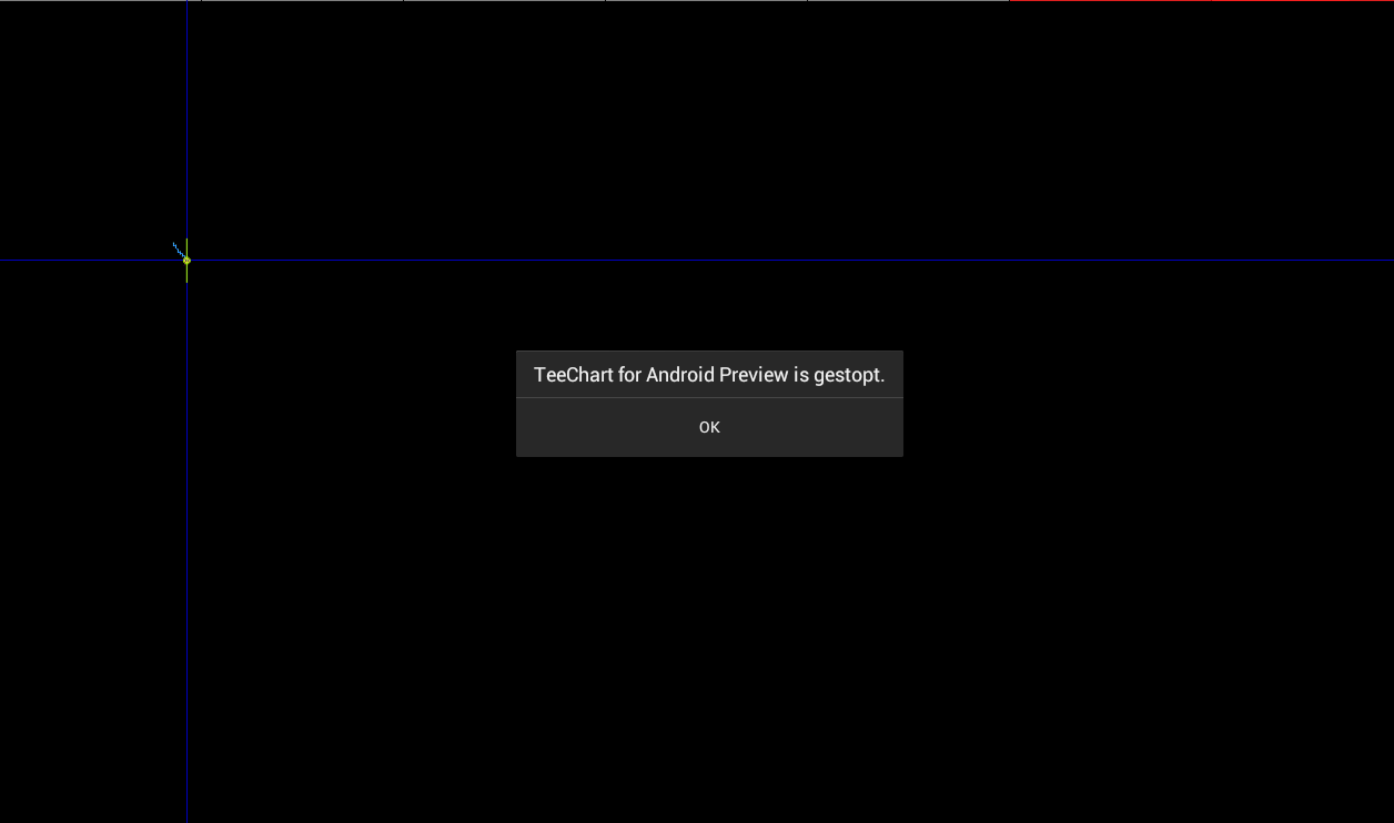

Here is the fourth picture.
