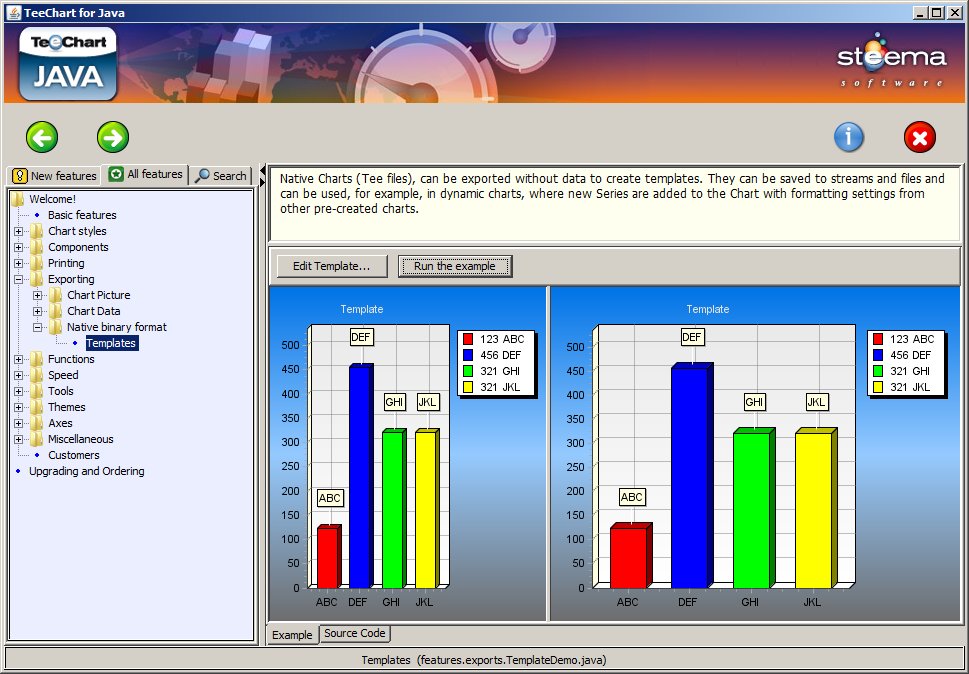

Re: TChart serializable problem
I've just run TeeChart.Features.jar from TeeChart Java Suite with SourceCode v3.2013.0517. I went to the "Negative Stacked" example, opened the editor, navigated to the "Export\Template" tab. Checked the "XML Format" checkbox and pressed "Save" button.
Find attached the xml generated. It looks correct. Do you see any difference between what we are doing?

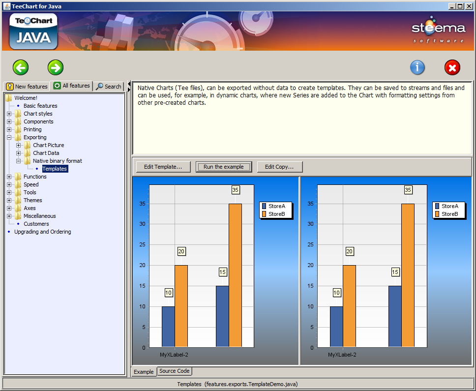

Hello, Yeray
I did not run it by the TeeChart.Features.jar.
I put the releated example code into netbeans, and run the example from netbeans.
in the output window of nebeans, some errors display.
I think even there is error, the TeeChart.Features.jar has no place to show it, because the error will be catched.

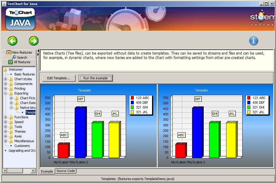

Although I get a correct xml file, I get many errors with the Suite with Sources v3.2013.0517. Find the errors attached (I attached a text file because the string is too long for a post).
However, I don't get any error with the actual sources we have here, so they shouldn't appear in the next version.

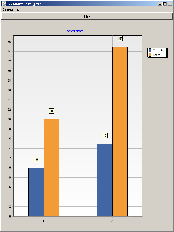

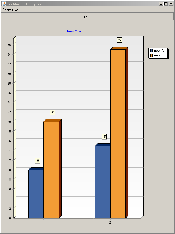

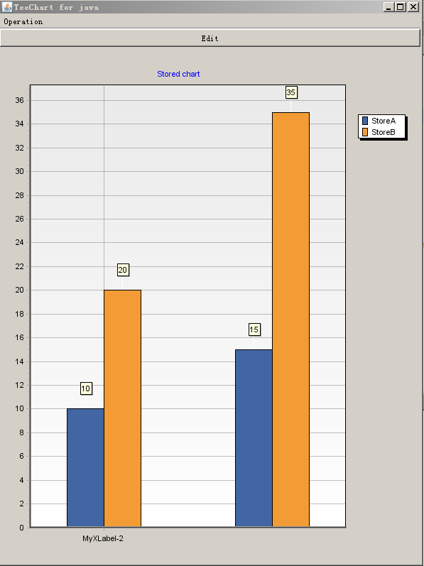

Hello, I download the new version TeeChartJava 2013.1219.
But the export import functions still have some problem.
My goal is exporting Tchat to tej or xml, then when i load it, it should be the same to the one i stored.
But this is false.
the following is my code.
1. tej xml problem
I store the Tchart to c:\\tt23.xml and c:\\tt23.tej. (Stored Chart.png)
But when i load c:\\tt23.xml, the X axix label is not "MyXLabel-2". (xml loaded.png)
when i load c:\\tt23.tej, the "Stored chart" does not showed. Nothing changed (tej loaded.png)
What's more, there are some errors in the IDE outp0ut. My IDE is netbeans.
2. i want to know how to calculate the correct position of label item. so "MyXLabel-1" and "MyXLabel-2" can be presented correctly.
"bottom.getLabels().getItems().add((double) 0, "MyXLabel-1");" // in fact i want to add "MyXLabel-1" as the first label
- xml loaded.png (16.29 KiB) Viewed 38559 times
After the program runs. please click operation--> save.
Then click operation--> load
The output errors are:

We've made some tests with the Swing features demo shipped with the installation, concretely with the example at "All features\Welcome!\Exporting\Native binary format".
- With NetBeans, create a "new project from existing sources" and use the features demo project at "Examples\Swing\Features\src\features"
- Open the project properties and make it use the TeeChart.Swing.jar at the Libraries menu.
- Change TemplateDemo.java with the following:
It seems to work without problems:
It also shows the same good result if I change the code for the "run button" to use a tej file instead of a memory stream:
So, try adding the copyChart.refreshControl(); call after importing the tej file.
Also please check your project is referencing the correct jar and not a TeeChart.Swing.jar from a previous version.

2. your test is using the example at "All features\Welcome!\Exporting\Native binary format".
But "MyXLabel-1" is still not showed corrected. only "MyXLabel-2" is showed.
3. Yes, I believe there is no error in your test. I also try your test immediately. But one test may be not enough.
Could you please spend some time on my test example and tell me what's wrong with it?
I think my test example uses the correct export and import methods provided with TeeChart.
After my example started, I click operation--> save.
Then click operation--> load, the saved tchart will not presented correctly.
I am confused with this problem for several months.

In your sample code you are adding data at X 1 and 2:
..and you are adding the labels at 0 and 1. At 0 there is no data and so no label appears. There are other ways to paint labels at all locations if required.
Alternatively there are different approaches to adding labels.
For example you could add them with the data:
will give the following output:
or you can override the default labels as you have done (here applying the index to two of the points that have been added):
That will give the following output:
I hope that may be of help.
com.steema.teechart.styles.Bar bar = new com.steema.teechart.styles.Bar(chart1.getChart());
bar.clear();
bar.add(0, 123, "ABC", Color.RED);
bar.add(1, 456, "DEF", Color.BLUE);
bar.add(2, 321, "GHI", Color.GREEN);
bar.add(3, 321, "JKL", Color.YELLOW);
chart1.getSeries(0).setTitle("A series");
bar.clear();
chart1.getAxes().getBottom().getLabels().getItems().add((double) 0, "MyXLabel-1");
chart1.getAxes().getBottom().getLabels().getItems().add((double) 1, "MyXLabel-2");
