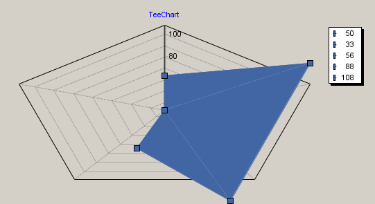

I create a radar in TChart and put it on a JPanel,
When i change the size of panel,
the radar will change the size of itself. However,in a wrong way.
When I compare the radar with the radar generated by excel,
this confirm my judge.
Could you please tell me how to address this problem?

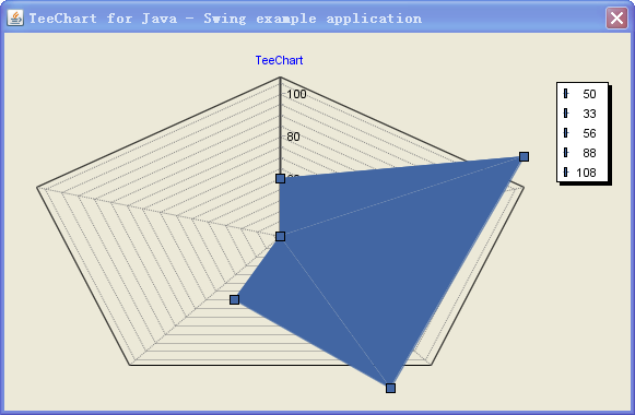

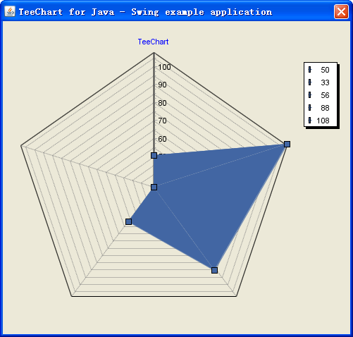

My code is as follows.
In the attachment, you can find two png files.
In the first png (radar1.png), you will see the radar graph is wrong.
In the second png(radar2.png), you will find that the value "33" is not showed correctly either.
Thus, when user changes the size of the dialog, the radar graph changes in a wrong mode.

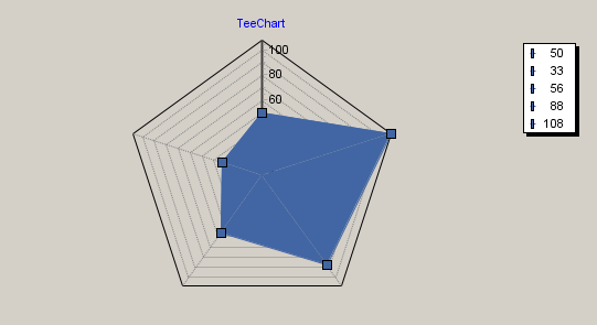

Gives me this:
That looks as your radar1.png image. However, I'm not sure to find any alternative in your code to generate the radar2.png.
Also, in radar2.png I think the value "33" is drawn correctly. Note it's the lower value in the series, so the axis minimum starts on it by default, so it's drawn on the center.
Then, adding this:
I think will give you the expected result for radar1.png.
And adding this:
I think will draw the "33" where you'd expect.

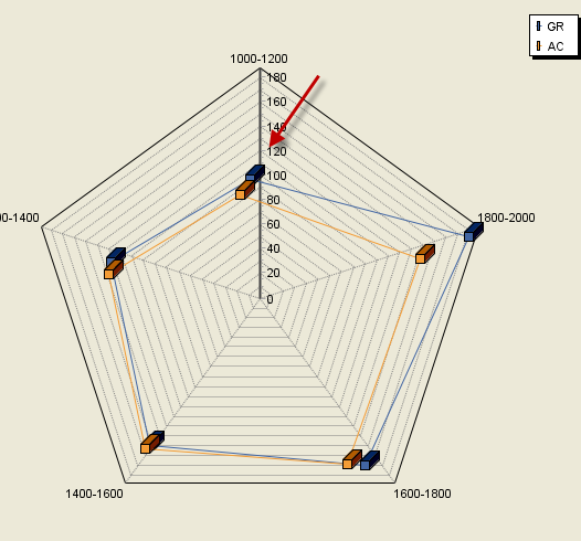

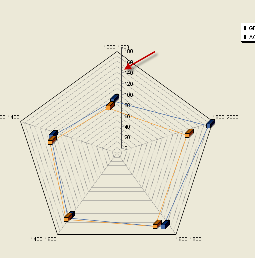

I encounter a strange problem with radar graph.
the axis is not in the right position.【radar axis wrong position.png】
what i need it the one in the attachment 【radar correct position.png】.
How can i set the current position of this axis by myself.
is it radar.getVertAxis()... or something else?

I can not reproduce this. Are those screen-shots made with different TeeChart versions? Otherwise, which settings differ from one chart to the other?
Re: problem with radar
I am sorry for late reply because of something.
This always happens when i saved the radar graph as xml files and import it again (in my software which integrates Teechart).
However, i can not reproduce this problem by a simple example.
this screen-shots use the same and latest version.
