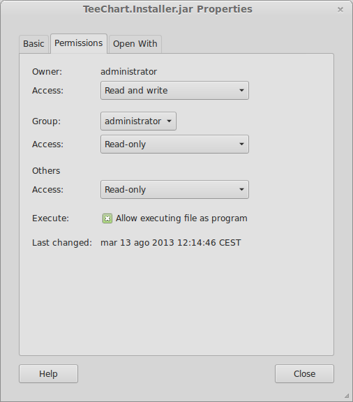

Post by Yeray » Tue Aug 13, 2013 10:18 am
I had to make TeeChart.Installer.jar executable before running it, but it worked for me here in a Linux Mint 15 with your license information and TeeChartJavaSrc_3.2013.0517.zip.

Thank you for your post. I made the installer executable
chmod a+x TeeChart.Installer.jar
and then reran it
java -jar TeeChart.Installer.jar
and entered the license information. The "Next>" button in the
"TeeChrt Pro for Java Installation" window remains greyed out.

I don't think you should find much problems with it. The tests I made (above) were with Linux Mint 15, that is based on Ubuntu (Debian), but I don't think it will be very different in Red Hat.
If you still find problems with it, please don't hesitate to let us know.
