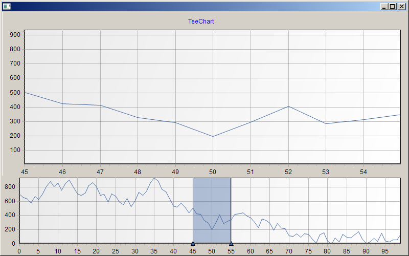

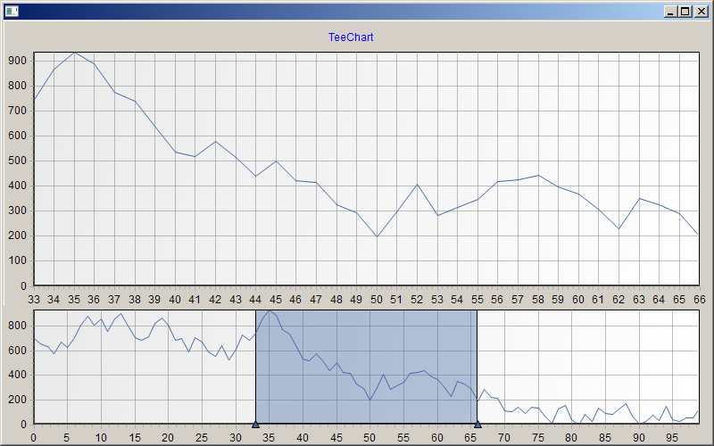

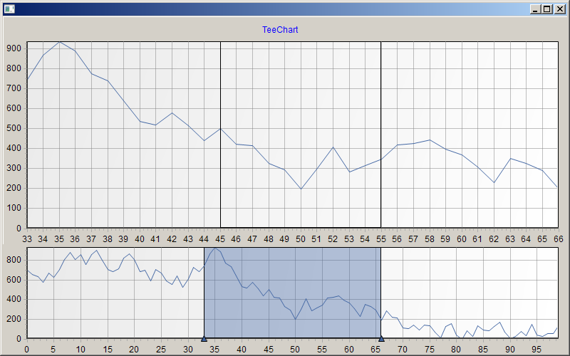

It seems to work fine for me. Look at the following screenshots: This is the code I used, with TeeChart Java SWTSetOnHi wrote:Also it seems the lower panel used to scroll is not using gridbag layouts so that when I resize the main window the lower panel is not resized automatically.
Is this true?
This cannot be used for commercial use without this feature [ autoresizing ]
tChart1.getLegend().setVisible(false);
Line line1 = new Line(tChart1.getChart());
line1.fillSampleValues(100);
tChart1.setBounds(Utils.fromLTRB(0, 0, tChart1.getParent().getSize().x, tChart1.getParent().getSize().y-20));
ScrollPager scroPag1 = new ScrollPager(tChart1.getChart(), tChart1.getParent(), 0);
scroPag1.setSeries(line1);
