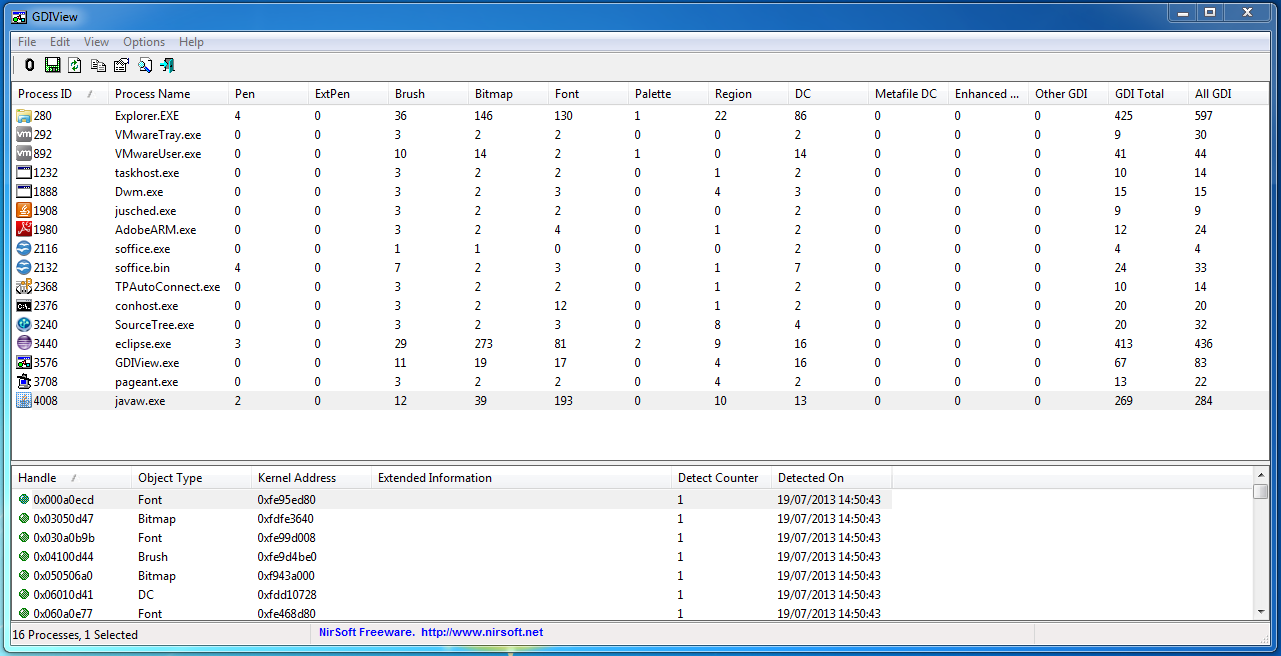

Re: Memory leaks 2
Ok, click on chart now doesn't launch any exceptions.
But there is still a memory leak with fonts... for example try to move mouse over a chart, it increases gdi.
Here I attach a screenshoot of gdiview of my application (pid 4008) after a some time. Ishan.
