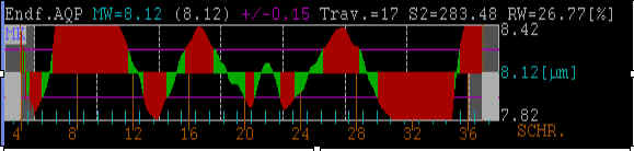

I'm a developer in a factory of PP films (used for packaging e.g. chips, cigarettes, ...) Produced film coming out from extrusion has thickness between 3 and 100 micrometers and it's very important to see quality of film (here the thickness profile) every time. From a gauge system, I'm getting the thickness profile (about 400 values of thickness) and I have to display a chart like this one:
Important are the red areas which should indicate a region over the width of the film not being in specification.
How can I achieve this with TChart (Java) ? Areas must be red when the chart is crossing the two horizontal lines

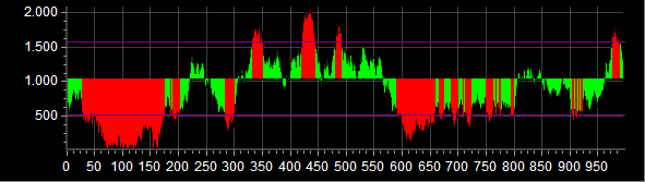

Post by Yeray » Fri Sep 28, 2012 12:22 pm
Hi Hubert,
Yes, you can assign a color (red or green) to each point, relative to the point value.
Here you have an example:

mora
Posts: 19
Joined: Thu Sep 27, 2012 12:00 am
Re: Color areas in line chart
Post by mora » Fri Sep 28, 2012 12:48 pm
This is exactly what I need
... and so easy.
Sorry, I'm quite a bloody newbie

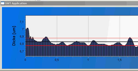

Post by mora » Mon Oct 01, 2012 6:53 am
Thx again.
But now I have another problem.
I used your code and it works fine. But when I wants to use "smoothing" the chart is no more what I want.
In detail : when I use area.setSmoothed with parameter true or false the chart looks always like
Parameter does not matter.
Is this a bug or normal behavior
Regards
Hubert
Post by Yeray » Mon Oct 01, 2012 8:52 am
Hi Hubert,
The setSmoothed() function creates an internal series with new values calculated with an interpolation from the source series. And then this internal series is drawn and not the source series, so the colors you applied to the source series won't be shown.
To work around this, you could create the internal smoothed series manually, and assign the colors to its points:

mora
