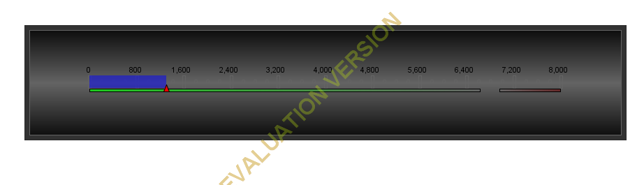

I'm trying to change the color of the value bar on the linear gauge. Can't get it to work. I've tried:
linearGaugeSeries = new LinearGauge(chart1.getChart());
linearGaugeSeries.getValueAreaBrush().setColor(Color.RED);
linearGaugeSeries.getValueAreaBrush().setForegroundColor(Color.RED);
linearGaugeSeries.getFaceBrush().setColor(Color.RED);
linearGaugeSeries.getFaceBrush().setForegroundColor(Color.RED);
but it always stays blue like this screenshot. This is with the v2012 evaluation version.
linear gauge color.png (14.45 KiB) Viewed 18610 times

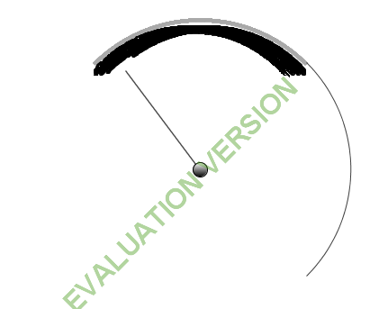

Also having a probelm setting the increment on a regular Gauges series.
double dHigh = 8000;
double dLow = 0;
gaugeSeries = new Gauges(chart1.getChart());
gaugeSeries.setMinimum(dLow);
gaugeSeries.setMaximum(dHigh);
gaugeSeries.getHorizAxis().setIncrement((dHigh - dLow)/10);
gaugeSeries.getVertAxis().setIncrement((dHigh - dLow)/10);
chart1.getAxes().getLeft().setIncrement((dHigh - dLow)/10);
chart1.getAxes().getBottom().setIncrement((dHigh - dLow)/10);
gauges no increment.png (13.64 KiB) Viewed 18581 times

mts wrote:I'm trying to change the color of the value bar on the linear gauge. Can't get it to work.
Try with:
linearGaugeSeries.getHand().setColor(Color.RED);
mts wrote:Also having a probelm setting the increment on a regular Gauges series.
You are right. It seems the Gauges axis increment is forced to 10. I've fixed it for the next maintenance release so this will work fine:
