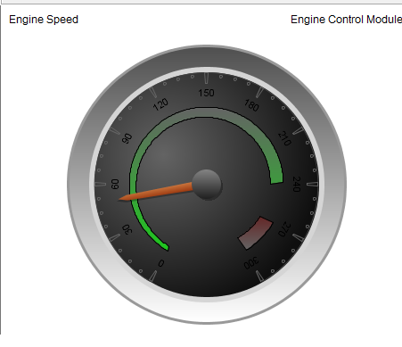

For example, I can change it for this:
And I get this, what I'm not sure if it's something similar to what you expected:
It inherits from Series class, and that's why it has the add() methods, the XValues and YValues ValueLists, etc... but they aren't used. Well, only the YValue[0] is used, but it's thought to be modified through the setValue() method.
I hope I've clarified it a little bit. If you still have any doubt, don't hesitate to let us know.

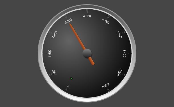

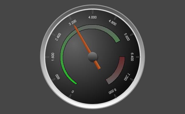

This is what I get with your code: I see the needle at 3200 as set with the setValue call. What I see at 0 are the geen and red lines, but you haven't set them as the rest of the gauges so theay still have the default values, that are 0-70 for the green line and 80-100 for the red line.mts wrote:The gauge is just staying at 0. Not sure why.
gaugeSeries1.setGreenLineEndValue(5600);
gaugeSeries1.setRedLineStartValue(6400);
gaugeSeries1.setRedLineEndValue(8000);

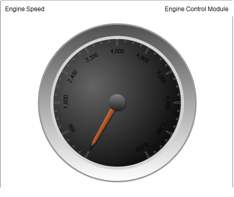

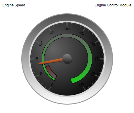

Ok I got it to work only when I set the limits to 300 or less. I attached three screenshots, one is chart limits of 0-300, another 0-400 and last one my desired 0-8000. All three have the axis increment set at high - low / 10. I also set the green line and red line at 80% and 90-100% of the value as follows:
gaugeSeries1.setGreenLineEndValue(dHigh * .
gaugeSeries1.setRedLineStartValue(dHigh * .9);
gaugeSeries1.setRedLineEndValue(dHigh);
I set the chart value to 50 for all three charts with:
gaugeSeries1.setValue(50);
The chart 0-300 looks as expected. I get a nice gauge spanning 0-300, increments every 30, the green and red lines look good and my value looks correct. But in all the others it's all wrapped around. You can see in the 0-400 the increments are right but the green and red lines wrap around and the value is approx 70, not the desired 50. This wrap around effect just increases as I set the series limits higher to 500, 600 etc. Then on the 0-8000 chart you can't even see the green/red lines, even though they are set, and the value of 50 doesn't even register. Actually no values register. I am getting no exceptions, just nothing is happening.
Is there some setting not right that is causing my chart to wrap around when it exceeds this 300 limit?

- chart bad 0-8000.png (38.05 KiB) Viewed 23650 times
- chart bad 0-400.png (40.58 KiB) Viewed 23659 times
- chart good 0-300.png (39.91 KiB) Viewed 23654 times
