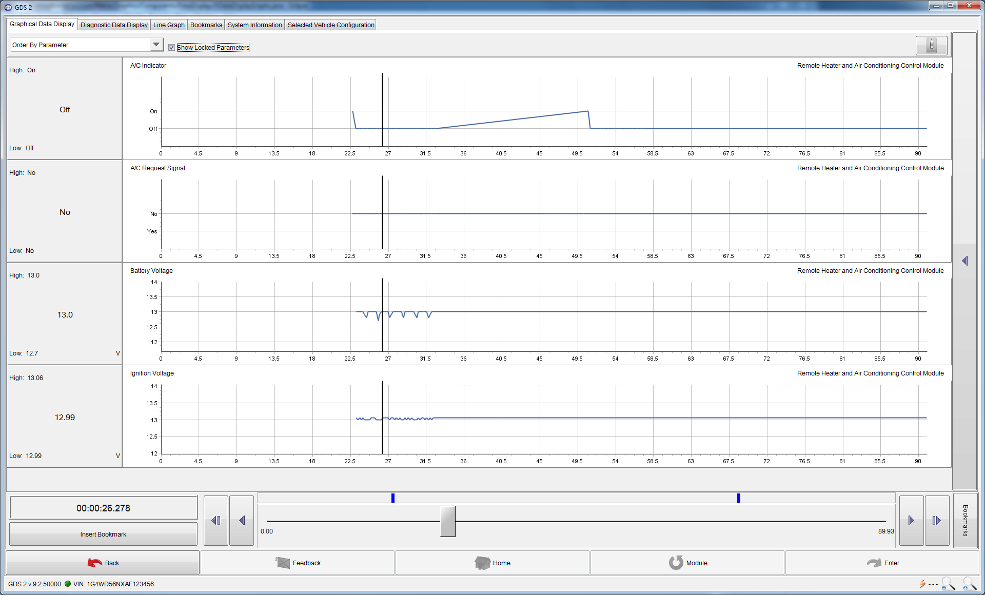

I have built a UI that is a JScrollPane with multiple charts aligned vertically. The number of charts varies but is usually around 30. Some of these charts graph numbers and others use custom labels to graph states like 0 = Off and 1 = On. When I only implemented the numbers everything worked fine. As soon as I added custom labels to display the strings like On and Off I started getting a lot of exceptions on the paint. This exceptions don't happen every time, but they do happen with enough regularity to reproduce and make the software unusable. I have tried to catch the exceptions when I call paint directly but they occur when the chart auto paints as well so I can't capture all of them. Here's what I'm getting:

I'll attach a screenshot of what my layout looks like. Here is a code snippet of how I initialize the chart and series and where I call get size labels, since that call seems to be throwing an exception. Also I call repaint directly because I do some custom drawing on the chart when the user moves a slider.
Here's where I initalize the chart and series (note that SEVPair is the state where 0 = the string On etc, this is not used on every chart but only some):
chart1 = new TChart();
fCreateReader();
fDoCommonMouseDebugSetup(null);
lineSeries1 = new Line(chart1.getChart());
lineSeries1.getLinePen().setWidth(2);
lineSeries1.getPointer().setStyle(PointerStyle.CROSS);
lineSeries1.getPointer().setVisible(false);
lineSeries1.getPointer().setColor(com.steema.teechart.drawing.Color.black);

Exceptions while painting custom labels
- graphs2.png (178.43 KiB) Viewed 10644 times
Re: Exceptions while painting custom labels
Hello mts,
I'm trying to use the code snipped you posted in a new simple application to test it and try to reproduce the exceptions but I can't. There are some undefined variables and methods I can't know what are they doing.
Could you please try the recently published v3 BETA to see if the problems are still reproducible with it in your application?
If they are still present, please, try to arrange a simple example project we can run as-is to reproduce the problems here.
