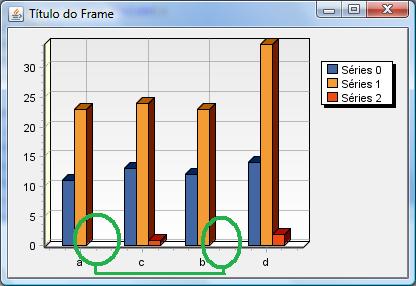

I need to show 0 value in a Bar3D. I have the code below. What should I change?
Bar b = new Bar();
        b.getMarks().setVisible(false);
        getChart().addSeries(b);
        b.add(1, 11, "a");
        b.add(3, 12, "b");
        b.add(2, 13, "c");
        b.add(4, 14, "d");
        b = new Bar();
        b.add(1, 23, "a");
        b.add(3, 23, "b");
        b.add(2, 24, "c");
        b.add(4, 34, "d");
        b = new Bar();
        b.add(1, 0, "a"); //Zero values, here is my problem
        b.add(3, 0, "b");//Zero values, here is my problem
        b.add(2, 1, "c");
        b.add(4, 2, "d");

We made a change in the sources to fix the problem detected here. This fix consisted on not drawing the Bars with value=0. Now I've modified it so the zero values won't only be drawn when MultiBar style is STACKED, STACKED100 or SELFSTACK. So it will be available with the next maintenance release.
In the meanwhile I'm afraid the only thing I can think right now is to change your 0 values to something little but different from 0, for example 0.01.

Thank you so much . Meanwhile I will use the value 0.001
