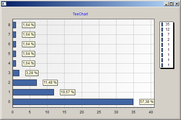

With the actual sources it has been modified and the result I get with your code is now the following:
So the next release should behave as shown.
