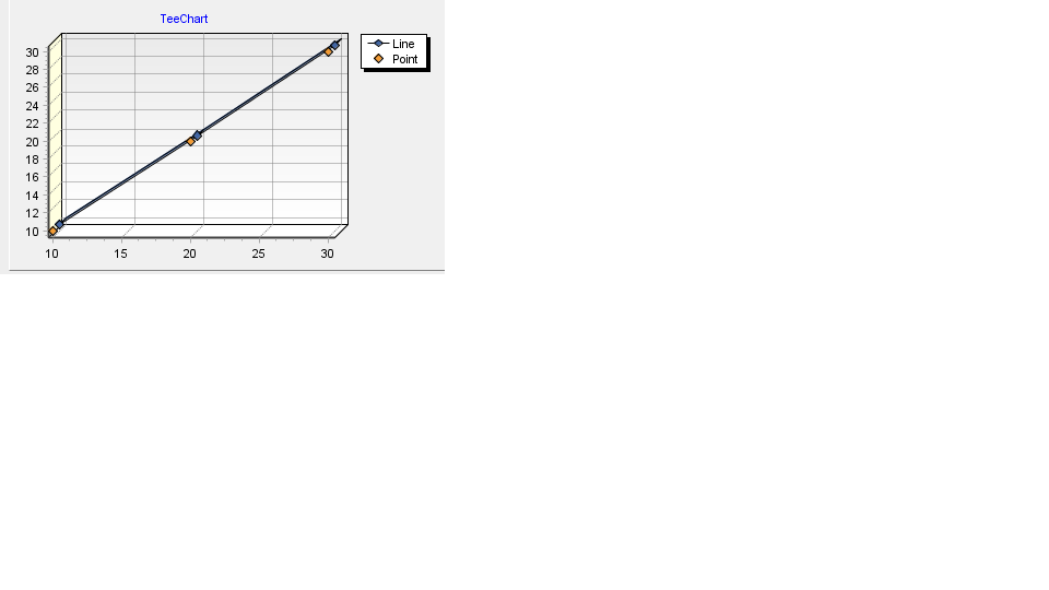

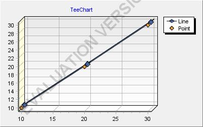

Adding "tChart1.getLegend().getSymbol().setWidth(20);" gives me the same result. I attach a screenshot of the result. In the screenshot, you will see that the diamond shape in line is smaller than the one in point. I am talking this in the legend. Yes, it is clear on chart, but it is less clear in the legend for the line symbol when it is diamond shape. When I have many other shapes in the legend, it is hard to tell whether that is diamond or circle.
example from eclipse environment
smaller diamond shape for line in the legend.png (23.03 KiB) Viewed 25564 times

In which environment do you get this? Using Netbeans with latest TeeChart for Java v2 version available I get the same you get in Eclipse. I have also added the issue (TJ71015544) to the defect list to be investigated.

Thanks for your feedback. Both screen-shots were generated with Eclipse and the same TeeChart version? Probably first screen-shots seems worse to me due to symbol brush and pen colors matching.
As for updates on TJ71015544, I recommend you to be aware at this forum, our RSS news feed, twitter and facebook accounts for new release announcements and what's implemented on them.

As I added comments right below those images, Both screen-shots were generated with Eclipse and the same TeeChart version. However, the first one was generated from my own application while the second one was generated from the 'Run-As' sample code. I am not sure why the first one looks worse than the second one. When you have time, could you explain more about your guess about the symbol brush and pen colors matching?

Sure. I meant that since those 2 colors where quite similar one can hardly tell the difference between pen and brush which makes the diamond symbol look less defined that the one where pen and brush colors are more contrasted.

FYI - I think the distorted looks come from symbol height. If you look at the sample chart I attached previously, you would notice that the symbols in line series is smaller than those in point series. I tried other shapes like circle..etc, and I could see again that the symbols in line series are still smaller than those in point series.
