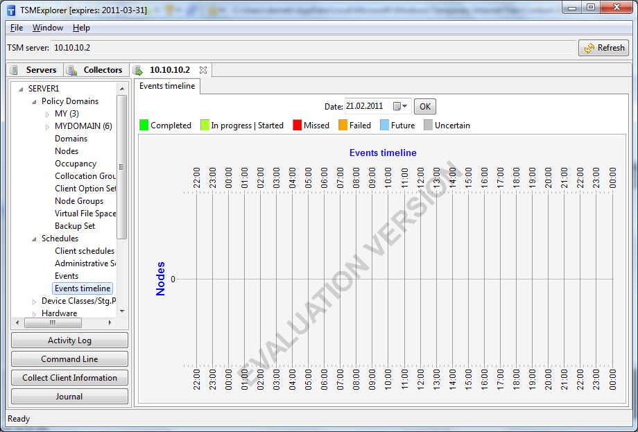

I have downloaded last version teechart for java. But It's evaluation version. Why? Previous version was correctly
- Clipboard-1.jpg (111.32 KiB) Viewed 25591 times

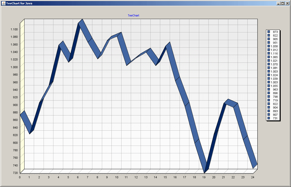

Here, I've just downloaded both the Evaluation (TeeChartJava2Evaluation.zip) and the Pro version (TeeChartJava2_with_Sources.zip) and I can show/hide the EVALUATION text simply changing the order of the paths in a NetBeans application: The test application only creates a Bar series and fills it with some sample values.

My screenshot is evidence too and I downloaded TeeChartJava2_with_Sources.zip. I use Eclipse (Helios).

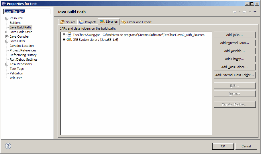

In Eclipse Helios and the following application I see this: In the case of Eclipse, I've seen that having both the eval and the Pro .jar in the list (ordered with your preference) doesn't seem to be enough and the "evaluation" text is always shown. So I have to remove the eval .jar from the library list to show the chart without the text. Could you please check it.
