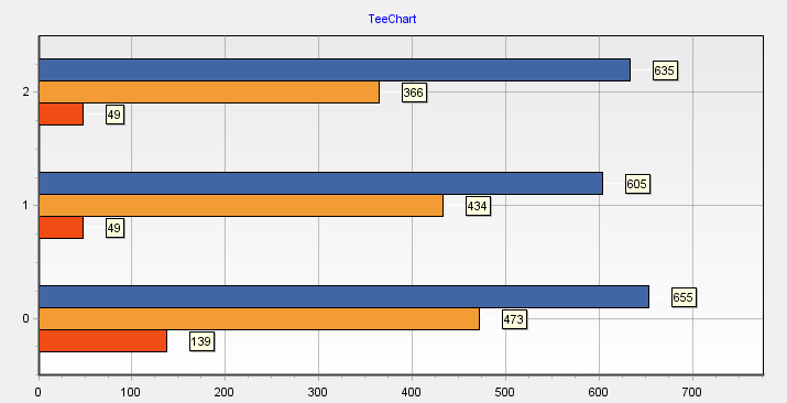

Perbit wrote:1.
Here you see, that when I scroll in the chart, the color-lines are getting over the drawing-area-bounds (see marked inside the red box). Is it an bug, or am I able to disable this?
This sounds the same discussed here:
http://www.teechart.net/support/viewtop ... 10&t=10658
Perbit wrote:2.
Here you see, that I need to have a chart, that is bigger than it is possible to show bars (because the place is very limited, where I draw the chart). The next bars (not able to be shown) should be able to be reached by scrolling. But you see, that the Chart-Axes are to big. As next you see in the red box, that the raster of the chart (name "2012") exceed the border of the drawing-area.
Is it possbile to get it cleanly?
I'm trying to reproduce this with the following code and TeeChart Java Swing and the following code, but it seems to work fine for me here:
        tChart1.getLegend().setVisible(false);
        for(int i=0; i<3; i++) {
            HorizBar bar1 = new HorizBar(tChart1.getChart());
            bar1.fillSampleValues();
            bar1.setCustomBarWidth(20);
        tChart1.getAxes().getLeft().setMinMax(-0.5, 2.5);
Could you please modify the code above (or arrange a simple example project) so we can reproduce the problem here?
