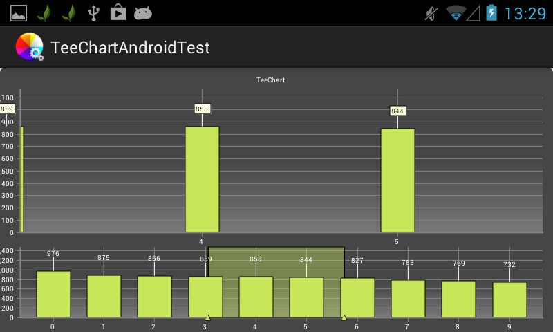

I’m using Teechart Java Android source code v3.2013.1219.
I'm having some issues presenting real time data using a Bar chart along a scroll pager.
I have modified the class WIFIStatistics in the Android teechart sample to present what I'm trying to achieve.
As you can see in the attached file, when pressing the "Start scan" button, a timer is initialized to retrieve data for a few times, representing the case where a real time data flow would need
to update the graphs.
WIFIStatistics.rar
(2.48 KiB) Downloaded 1820 times
1. Issue to update the subchart
The main chart is updated without any issue. However, in order to update the subchart I ended using the following code( after a lot of tries with other functions that
did not update the subchart)
// Remove series from the scroll pager
ScrollPager s = (ScrollPager)chart.getTools().getTool(0);
if (s != null) {
	TChart scrollPagerChart = s.getSubChartTChart();
	scrollPagerChart.removeAllSeries();
	s.setSeries(null);
Although the subchart is updated, it creates a flickering effect which I would like to avoid and have a smooth update as the update of the main chart.
How can I achieve it?
2. Issue to configure and retain state of the subchart's colorband
I need to support the following case:
a. Initially, the colorband is drawn at the default position (middle of x axis)
b. If the user changes the position or the size of the colorband, while the charts are updated in real time, the colorband should be drawn at the new position and its size
should be updated accordingly.
I tried different functions from the library and tried to implement relevant events to accomplish this, however, unsuccessfully.
Currently, the code used in the attached sample uses the default configuration of the colorband each time it gets updated. If you try to move the colorband while
the subgraph is updated, you will get an exception.
Could you please provide some sample code how to retain the colorband's position and size and also avoid the exception?
This feature is very important for the functionality I'm implementing.
Thank you in advance,
E.

Thanks for the change and the great support, it has solved my issues but I need some further assistance on the second issue.
I need to save the position/size of the colorband and propagate it in case configuration changes. This is for the case where you change the orientation of the device.
So, if the user is using landscape view and has moved/resized the subchart's panel, I would like to retain the updated position/size of the colorband at the portrait view.
I tried to configure the dragFinished event and then call the getStartLine and getEndlLine on the colorband but unsuccessfully. It seems that I have not configured the event correctly (how do you register the draglistener and where? on the scrollpager or on the colorband?) or I should have used something else to achieve what I want.
Could you please provide me with some sample code?
Also, I tried to set a legend below the subchart, however it does not show it. Is it possible to show a legend below the main chart or the subchart?
E.

I've made a simple example project to test this out of the Features demo because I don't ever get a unique bar here.
TeeChartAndroidTest.zip
(678.38 KiB) Downloaded 1723 times
And this is what I get:
Could you please modify the project above so we can reproduce the problem here?
