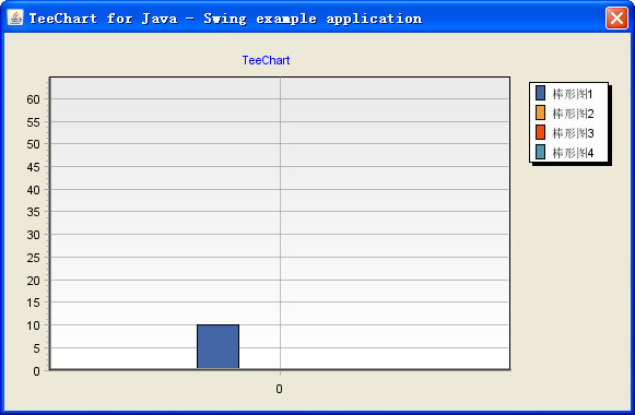

Post by rubby » Fri Aug 30, 2013 3:08 am
my code is as follows.
In the bar.png, you will find there is only one bar which is wrong.

Post by Yeray » Fri Aug 30, 2013 12:18 pm
That's a problem already present in the defect list to be fixed for further releases (TJ71016295).
I've incremented the ticket priority.

Re: Problem with Bar
Post by rubby » Tue Sep 24, 2013 2:26 am
hello,
I find an approach to avoid this problem by
chart.getAspect().setView3D(true)
does there exists some other approaches to avoid this problem?
e.g. set bigger distance between each bar? or something else?

Post by rubby » Tue Sep 24, 2013 3:08 am
luckily, i find a perfect approach to avoid the bar problem which is very common and confuse the users always.
(Bar)chart.getSeries(i).setMultiBar(MultiBars.SIDEALL)
