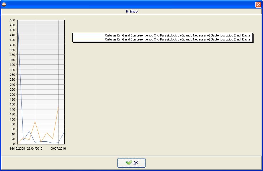

The legend of my graph is too large.
How can I reduce it?
Is there any way to break the line?
Re: Legend width
Post by Yeray » Fri Jul 16, 2010 1:43 pm
Hi Wheb,
You could change the series titles for something shorter:
        for (int i=0; i<tChart1.getSeriesCount(); i++)
            tChart1.getSeries(i).setTitle(tChart1.getSeries(i).getTitle().substring(0,10) + "...");
You could also set the legend position manually:
        tChart1.getLegend().setCustomPosition(true);
        tChart1.getLegend().setTop(100);
        tChart1.getLegend().setLeft(100);
Or you could try other automatic alignment:
        tChart1.getLegend().setAlignment(LegendAlignment.BOTTOM);
