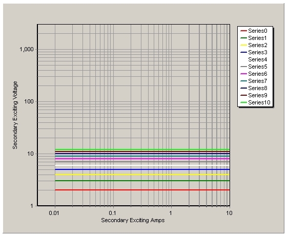

ITI
Posts: 8
Joined: Tue Apr 05, 2005 4:00 am
Re: problem with grid lines on logarithmic chart
Post by ITI » Tue Jun 23, 2009 2:01 pm
I've uploaded a screen shot showing the issue with the grid lines. The minor grid lines for 3, 4 and 7 are noticably thicker.

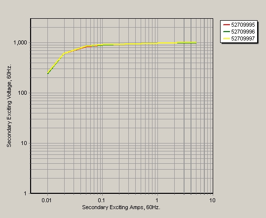

ITI
Posts: 8
Post by ITI » Tue Jun 23, 2009 3:39 pm
I've previously made a log/log chart in VB without a problem. But right now the problem I'm having is with ASP, not VB. I'm using teechart7.ocx version 7.0.1.4, which is installed on our server.
Here is my code. There are two ASP pages - one to create the chart and save to stream, one page to display the chart.

	Chart1.Axis.Left.MinorGrid.Width = 1
	Chart1.Axis.Left.MinorGrid.Visible = True
	Chart1.Axis.Left.Title.Caption = "Secondary Exciting Voltage"
	Chart1.Axis.Bottom.Automatic = False
	Chart1.Axis.Bottom.Logarithmic = True
	Chart1.Axis.Bottom.SetMinMax 0.005, 10
	Chart1.Axis.Bottom.GridPen.Style = psSolid
	Chart1.Axis.Bottom.GridPen.Color = RGB(153, 153, 153)
	Chart1.Axis.Bottom.GridPen.Width = 1
	Chart1.Axis.Bottom.MinorTickCount = 8
	Chart1.Axis.Bottom.MinorGrid.Style = psSolid
	Chart1.Axis.Bottom.MinorGrid.Color = RGB(153, 153, 153)
	Chart1.Axis.Bottom.MinorGrid.Width = 1
	Chart1.Axis.Bottom.MinorGrid.Visible = True
	Chart1.Axis.Bottom.Title.Caption = "Secondary Exciting Amps"
		For i = 0 to 10
			Chart1.AddSeries(scLine)
			Chart1.Series(i).Pen.Width = 2
			Chart1.Series(i).AddXY 0.01, i+2, "", clTeeColor
			Chart1.Series(i).AddXY 0.02, i+2, "", clTeeColor
			Chart1.Series(i).AddXY 0.05, i+2, "", clTeeColor
			Chart1.Series(i).AddXY 0.1, i+2, "", clTeeColor
			Chart1.Series(i).AddXY 0.25, i+2, "", clTeeColor
			Chart1.Series(i).AddXY 0.5, i+2, "", clTeeColor
			Chart1.Series(i).AddXY 1, i+2, "", clTeeColor
			Chart1.Series(i).AddXY 5, i+2, "", clTeeColor
			Chart1.Series(i).AddXY 10, i+2, "", clTeeColor
		Next
  	Response.BinaryWrite (Chart1.Export.asNative.SaveToStream(True))

Posts: 9674
Post by Yeray » Fri Jun 26, 2009 8:46 am
Hi ITI,
Thank you for the code! Yes you are right, I could reproduce it in v7 and I want you to know that I've tested the same code with v8 and couldn't reproduce it, so it seems to be solved from v8.
ITI
Posts: 8
Post by ITI » Fri Jun 26, 2009 1:54 pm
Thanks for checking into it. I guess we will just have to live with it for now.
