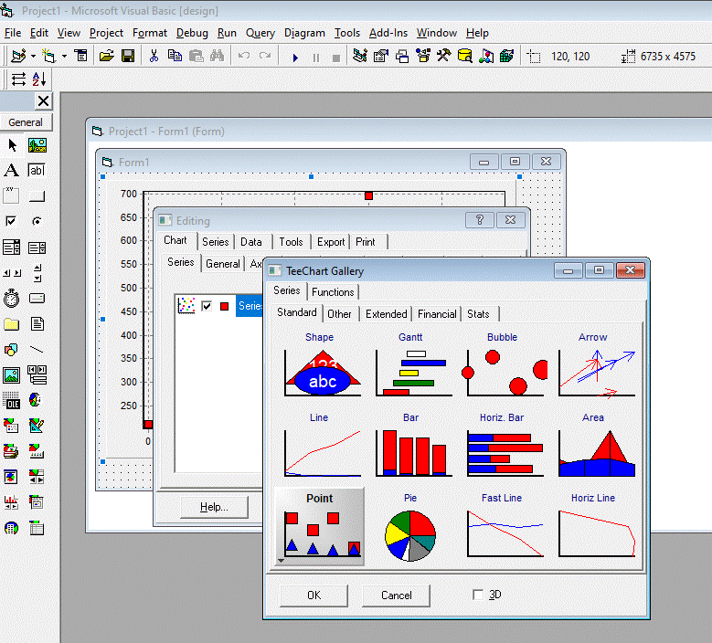

Is it possible to use editing and TeeChart gallery during development like screen shot in VS2022?
- TeeChartGallery.png (193.48 KiB) Viewed 48635 times

it's possible in the case you continue using NET Framework. If you're using or porting your applications to NET50 or NET60, then you wont be able to use designer for ActiveX controls, at least for now.
Microsoft decided to not introduce the designer for AcrtiveX controls for NET50 and NET60.
Here you can find more information :
https://developercommunity.visualstudio ... si/1435698
