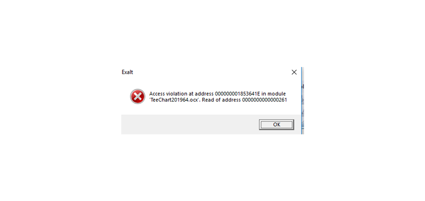

I have a real time application monitoring avionics messages which has been converted from 32bit to 64bit (VS 2008 C++) Teechart5 to TeeChart Pro v2019.0.4.25
I am using the same code as used with the 32bit version
When calling
m_tchart.ChangeSeriesType(series->m_iSeries, scBar);
or scPoint or scFastLine or scArea
I get the following pop up
After pressing OK the graphs appear and run.
If I change the type of graph at runtime I get the same result
sometimes i get an error message before calling m_tchart.ChangeSeriesType
Augument out of range
on this line
m_tchart.GetTools().GetItems(TOOLS_ALARM_YBAND2).SetActive(0);
However, I already passed this line before calling m_tchart.ChangeSeriesType without any problem?
Please advise,
Shia.

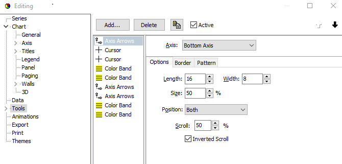

Thanks but I solved it.
The problems were caused when I copied for the old teechart control to the new (see attached file).
When I created the same tools in the new v2019 64bit version I changed the order,not realizing the order was important. 8)
There were hard coded index's referencing the tools (originally written in 2002!) :|
Therefore, I was addressing the wrong tool, hence the errors.
I just rearranged the tools as per the original version, and everything is working. :D :) :wink:
