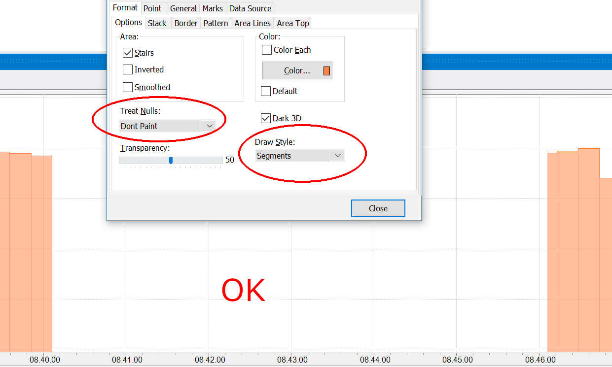

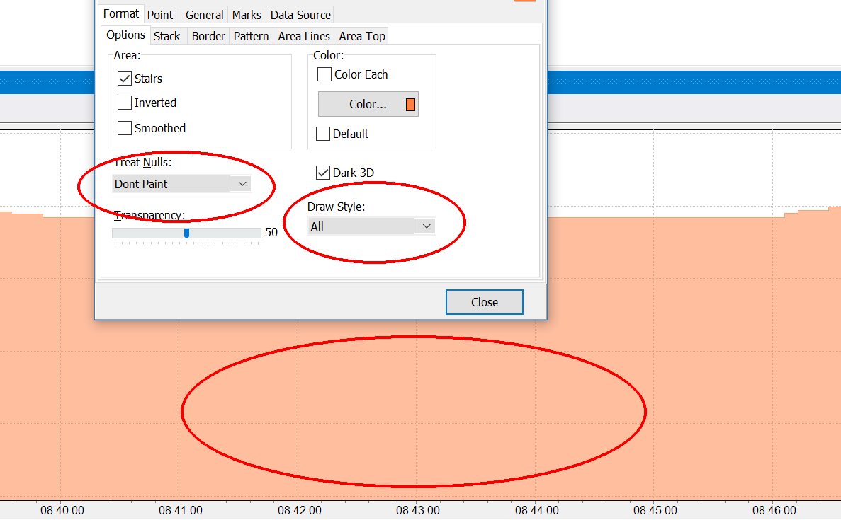

TeeChart 2019 area series has a new option "Draw style" and is as default "Segments". We do not want area drawn as boxes but like it was drawn when using older TeeChart versions so we tried to change "Draw style" to "All" which at first looked like the solution we want. However we found out that if "Draw style" is set to "All" then "Treat Nulls" option is ignored.
Is this a bug or works as intended? Is there a way to get area series drawn as it was using older TeeChart versions?
Also TeeChartDefines.h seems to miss area series draw style values.
- AllAreaSeriesWithNulls.png (42.48 KiB) Viewed 38793 times
- SegmentsAreaSeriesWithNulls.png (44.19 KiB) Viewed 38793 times

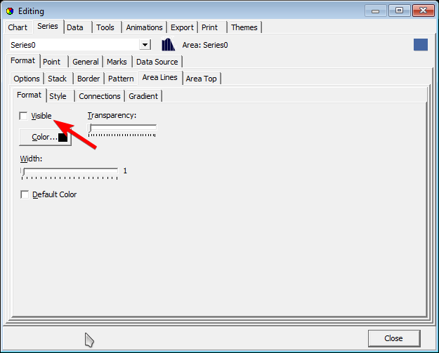

Have you tried to hide AreaLinesPen to avoid drawing the area "as boxes"?
By code:
By editor:
If this is not what you are trying to achieve, please detail what result were you getting with previous versions.
I'm afraid the "All" "Style" doesn't support null points.
By code:
tChart1.Series(0).asArea.AreaPen.Hide

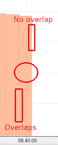

Area lines pen is not visible in those examples. I have tried to enable them and set transparency to 100% - no change, tried to set line width to zero - no change. Those lines always appear if area series transparency is not 0%. We need to set area series transparency to other than 0% (at least 20%) so that other series can be seen through it.
As I see it area lines is not a problem but segments are drawn a little overlapped and if transparency is not 0% overlapped areas become darker creating "area lines" of their own.
In older versions area series was drawn like "All" does now but did not ignore null points i.e. same as "Segments" now but without "area lines" of their own.
- Overlaps.png (12.3 KiB) Viewed 38746 times

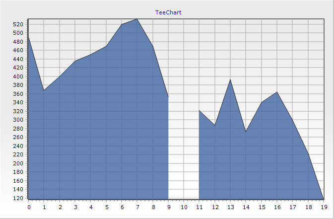

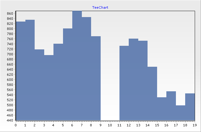

I can't reproduce the problem here. This is what I'm getting with the code below:
If you still find problems with it, please arrange a simple example project we can run as-is to reproduce the problem here.
With TChart1
.Aspect.View3D = False
.Legend.Visible = False
.AddSeries scArea
.Series(0).FillSampleValues 20
.Series(0).SetNull 10
.Series(0).asArea.AreaPen.Visible = False
.Series(0).Transparency = 20
End With
Re: Area series Draw style problem (TeeChart2019.ocx)

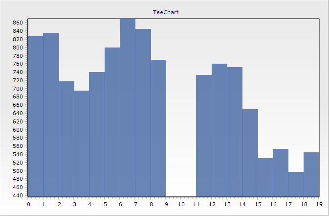

Try your example with "Area": Stairs like in my example and report back. You should see same behaviour. If I disable "Stairs" in our code extra vertical lines are not drawn like in your example code above.
My guess is area is drawn as polygon vs. rectangles (No Stairs vs. Stairs).
The lines aren't being drawn. However, the rectangles are being drawn so close that it looks like there was a darker line being drawn between them: If you change the Canvas to use GDI instead of GDIPlus, this effect disappears:
Note the default Canvas changed a few years ago from GDI to GDIPlus.
