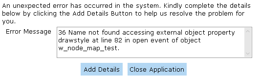

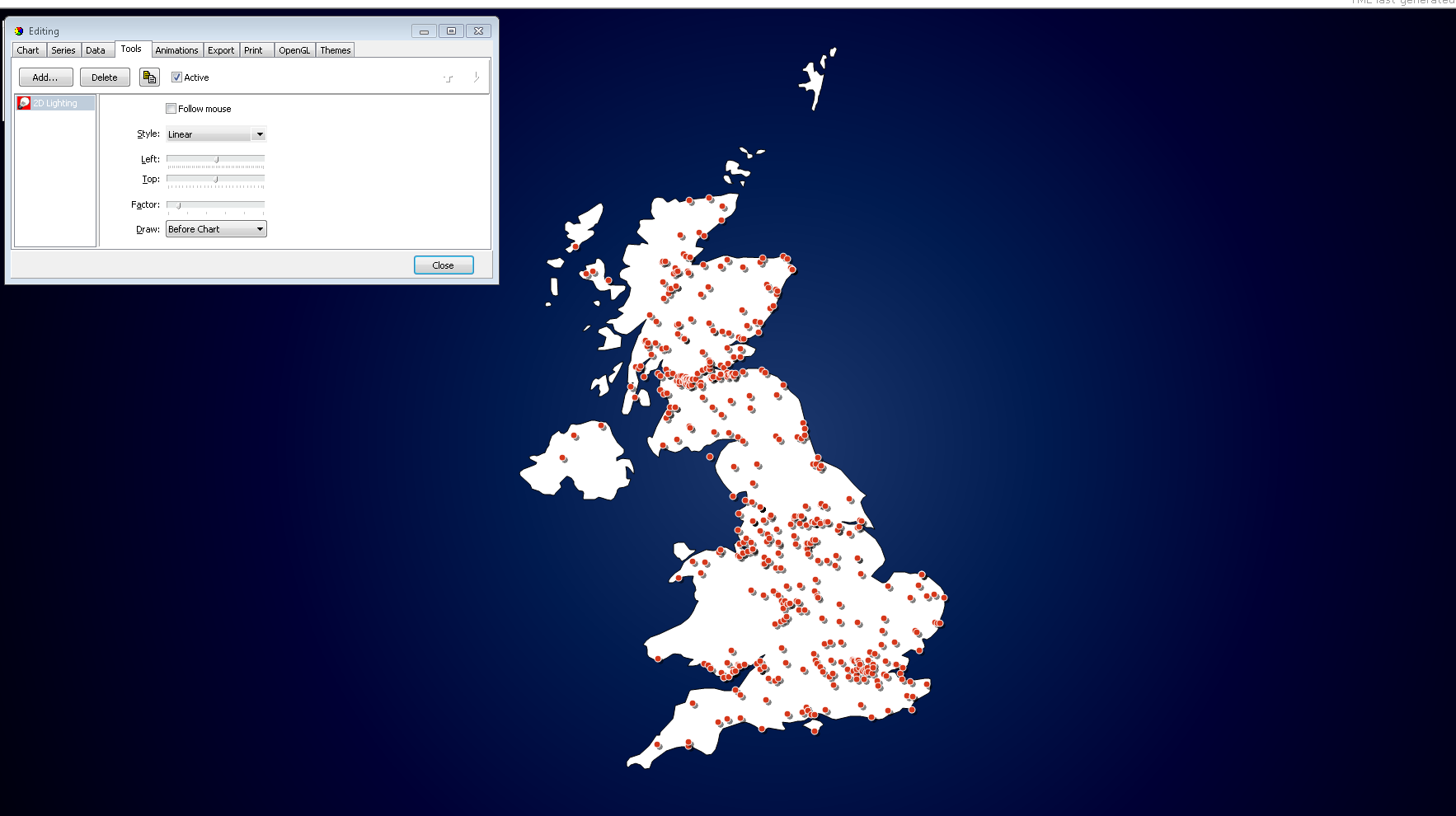

I've added a light tool to my chart but I want to set the DrawStyle property to be Before Chart. The property is not mentioned in the documentation and everything I have tried just errors with invalid property. Any ideas?
ole_tchart.GetChart().Tools().Add(u_tchart.ll_tool_Light)
ole_tchart.GetChart().Tools(0).asLight.DrawStyle = 2

Thanks but this is not helping.
The problem is not the definitions, it's the property I should be using. According to the VCL reference it should be DrawStyle but I just get an error saying it doesn't exist.
I can't set the Factor or Style property either. When I reference the tool using .asLight I get an object. As it's ActiveX it's impossible to inspect to expose the properties. All other tools I use work fine e.g. .asColorLine or .asScrollPager
I am using a build you sent me a few day's ago which had a bug fix in for Maps & Scroll Pagers. Could this perhaps be another bug?
